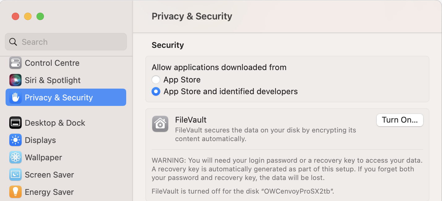

The choice you get is how you want to recover your FileVaulted drive should you forget the daily unlock one (same as the user). You can chose to either recover with your Apple ID or a standalone Recovery key.
Thanks guys for the useful info.
I just checked my FW within settings and it mentions nothing about a separate password or anything to do with passwords.
The only option I have is to turn FW off. And Warning blurb about needing your login password or key etc
Does this sound right?
Yep.
It’s not very complicated. On AS and T2 Macs, everything on the SSD is hardware encrypted with a volume encryption key, stored in the Secure Enclave. FileVault protects the volume encryption key with your user password, so nothing can be decrypted without the user password.
