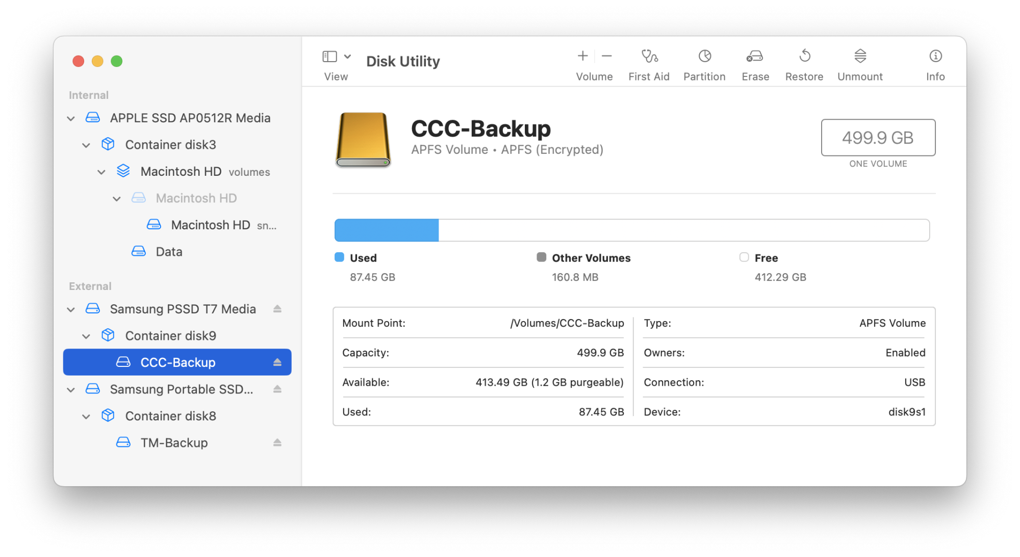

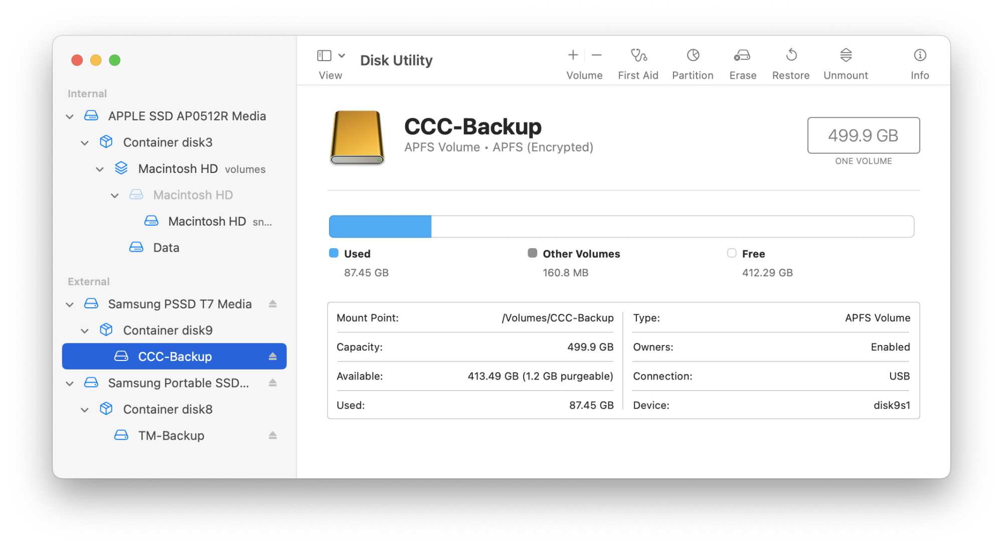

You can see here where I have my external CCC backup drive encrypted.

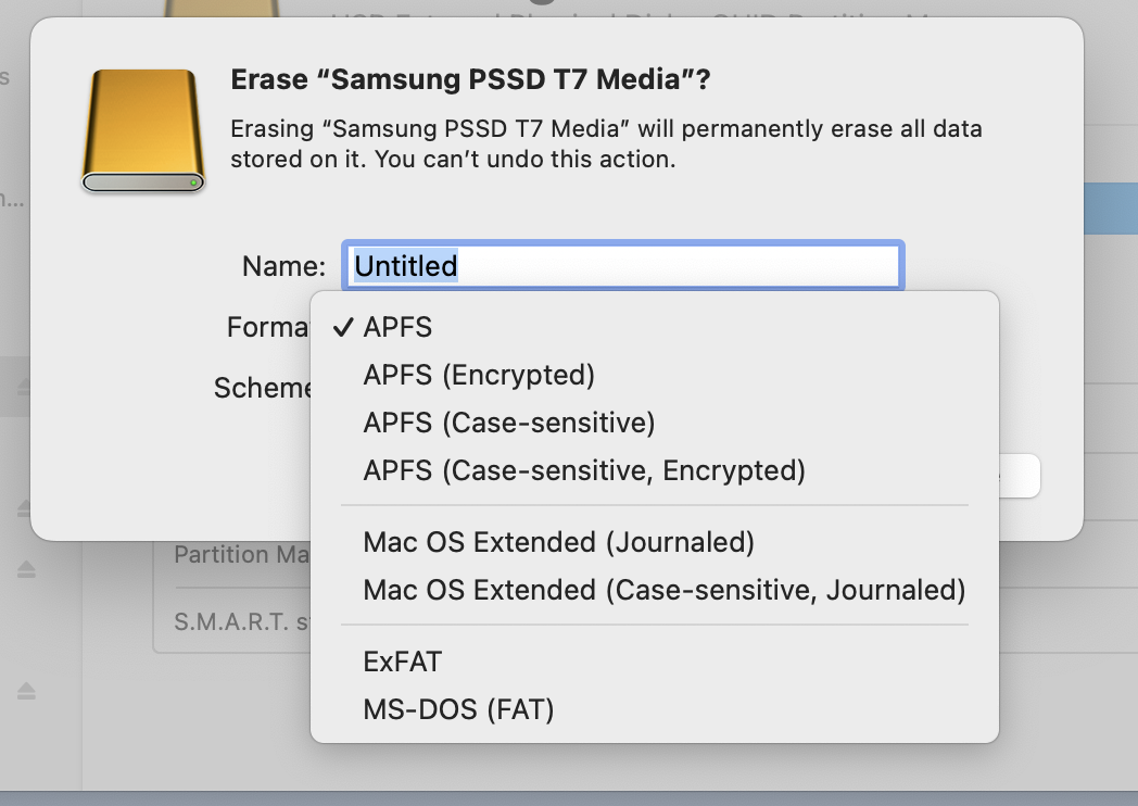

You can encrypt a USB key just like I did my drive. Just click erase in Disk Utility and select APFS encrypted.
