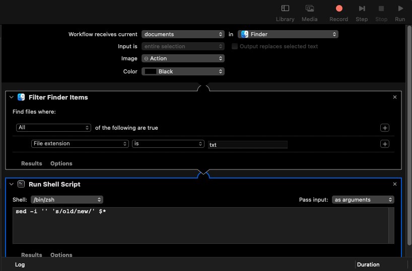

I use a QuickAction to replace a pattern of text inside files. Something like this:
Use Quick Action workflows on Mac https://support.apple.com/guide/automator/use-quick-action-workflows-aut73234890a/mac
@bogdanw thanx for idea with Quick Action. That looks smart. But I would like to learn to do it with Mac Terminal to be able to do much more stuff that might be not possible with Quick Action.

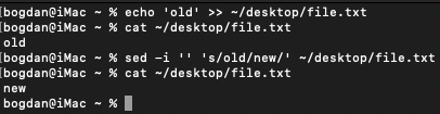

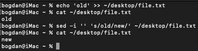

It's one line in Terminal:
sed -i '' 's/old/new/' ~/Desktop/aaa/*.txt
replaces the word “old” with the word “new” in all files with the extension .txt in the folder ~/Desktop/aaa/
