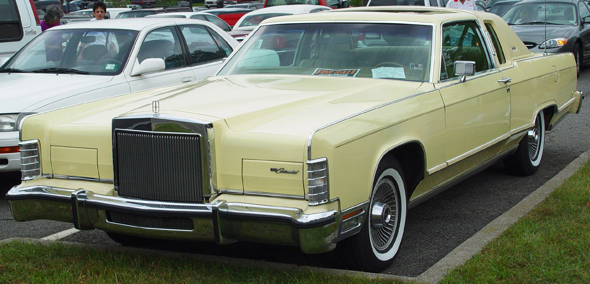

Working on the photos of the actual car, but for now, this will do: (What it should look like when finished :D)
