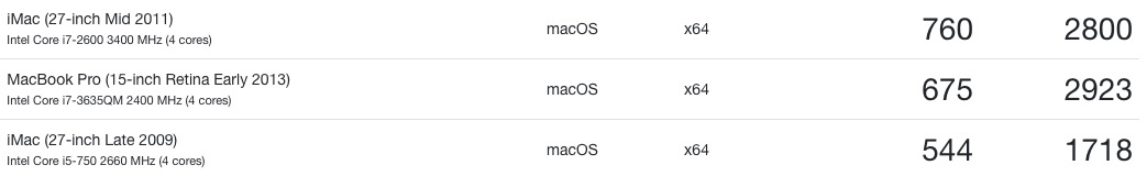

In the screenshot below you can see my 2009 and 2011 iMac Geekbench 5 scores, ignore the MBP. Smaller number is single core score and bigger multicore performance. That is quite a difference, the 2011 i7 is close to 40% faster in single core performance. Multicore is even more due faster cores, bus and memory.
Also the video card and SATA buses are faster in 2011 models.
I used to use 2009 iMac 27" C2D and i5 machines at work and home daily since new until 2022. Then I replaced them with 2011 i5 and i7 machines 3 years ago. I maxed the RAM and installed SSD to both. I now use primarily the i7 3.4GHz.
IMHO, it is a good upgrade.
A good addition was a elgato Thunderbolt dock 2, which upgrades the USB 2 to almost USB 3 speeds.
