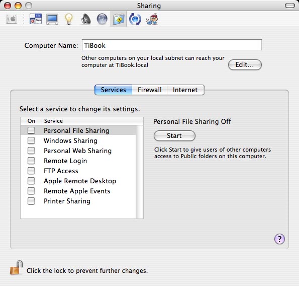

OK...my PowerBook seems to be sleeping on its own again. I upgraded to Panther (the easy upgrade way, no Clean Install). It was still having the same problem after going to 10.3, until I went into the Sharing settings and turned off everything, like so:
Oh, and by the way, out of that list, I had "Personal Web Sharing" and "Remote Login" enabled. Let me know if this fix works for anyone else...
My Powerbook is sleeping again too!!! I don't know what the problem was or what has changed. I never had Personal Web Sharing or Remote Login enabled.
