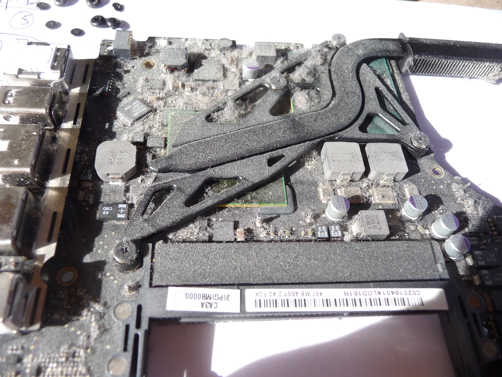

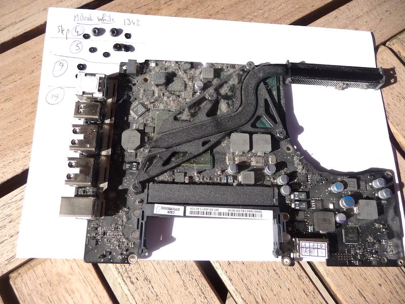

iii) Below: Closer view of logic board. The fan (not shown) was heavily clogged with dust, as was the heat sink exchanger (top right) most of the debris I removed just prior to this photo.

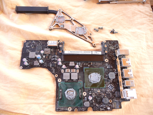

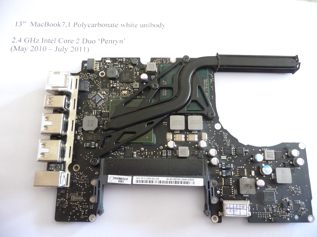

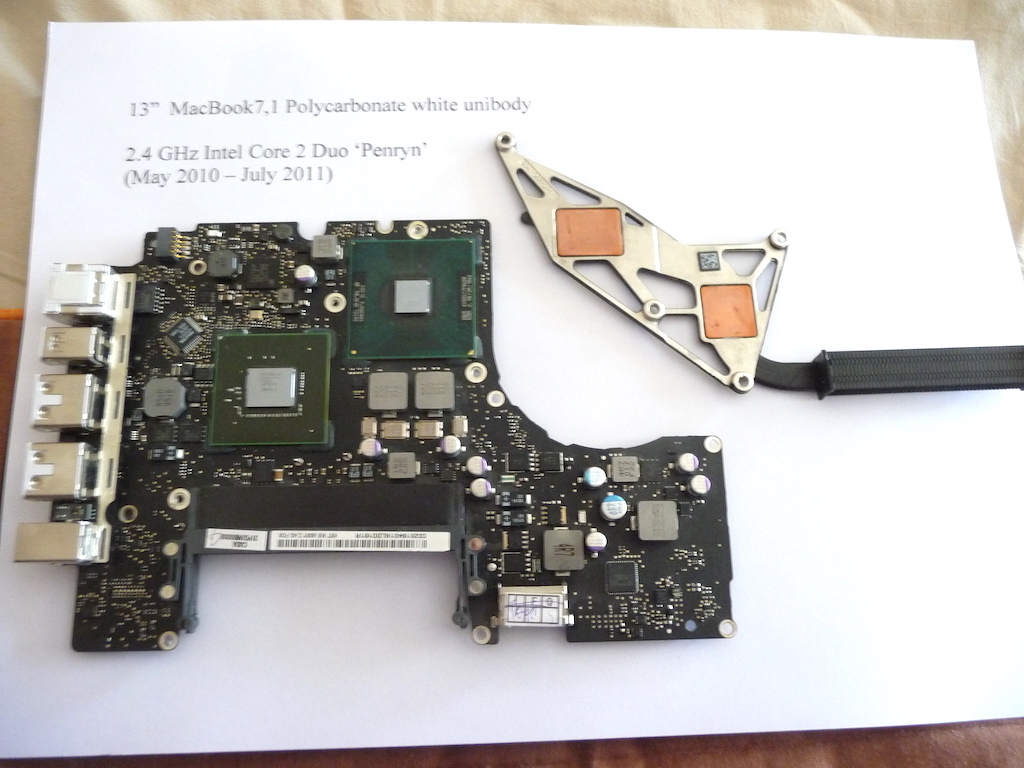

iv) Logic board lightly cleaned, heat-sink removed. (v) Further clean of logic board & heat-sink.

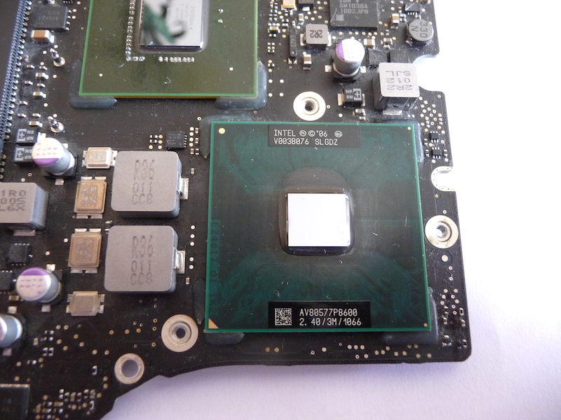

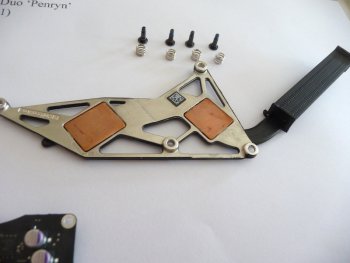

vi) Heat-sink and attachment details. (vii) Detail of the Core2Duo 2.4GHz processor.

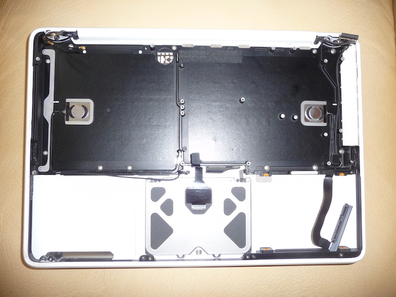

viii) Bottom case with screen removed. Areas which showed light cracking through the case were re-inforced using epoxy resin and lightly dressed out. (ix) Logic board/heat-sink assy prepared for re-installation.

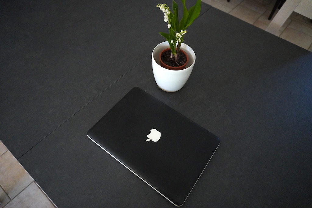

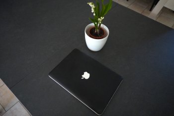

Before refitting all components I made several attempts at cutting strips of black carbon-look adhesive vinyl to the front, rear and sides of the bottom cover. Also similar sheets of black vinyl to the topcase and keyboard surround. The results unfortunately were not as I'd hoped for. Cutting around the keyboard surround power button and accessory ports was tricky, and also around the Apple logo & leaf on the top cover. Whilst many may have been satisfied and lived with the results, they were not as professional as I would have liked, and although only a small detail I wasn't happy that the etched icons of the usb/ethernet and other small accessory ports were masked by the black carbon vinyl. So I removed it all and tried a change of direction. Would an application of matt black 'Plasti-Dip' give better results?
An hour of careful masking and several coats of 'Plasti-Dip' later, it looked ok on the top cover, but didn't look right on the keyboard surround and sides of bottom casing.
So I finally ended up with a partially-black unibody MacBook, which I guess is fairly unique and aestetically I'm reasonably happy with, but reckon could do better if I ever attempt a similar modification.

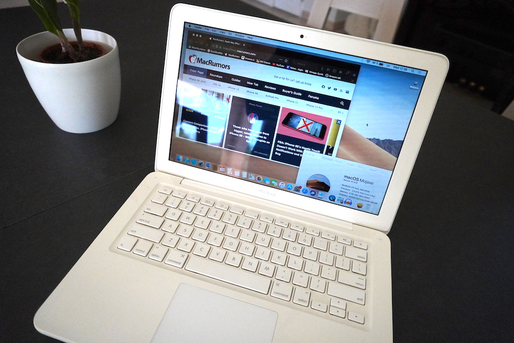

What I particularly like on this MacBook is the performance. I changed out the original HD for a Samsung SSD, and installed Mojave with the assistance of Dosdude's patcher. Thought I was pushing my luck attempting this with just 4GB of memory, but surprise, surprise it runs far better than I ever expected. In fact it's now in use for this post and has edited and attached the photos never missing a beat. I was going to upgrade to 8GB of RAM (16 would be overkill for my use) but with no heavy video editing planned I'll stick with the current 4GB.
The other very worthwhile changes were to install the latest Waterfox web browser, tweaked with FoxPEP and in use with DuckDuckGo for added security and privacy. Configured in this way, for internet use it's very rapid and a joy to use. All this for less than 100euros......

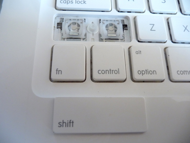

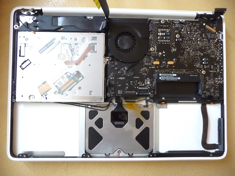

(i) Left: Keyboard was in reasonable shape but the shift key had become detached. (ii) Right: Logic board after removal.

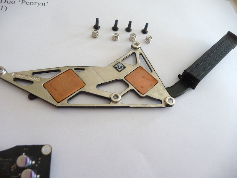

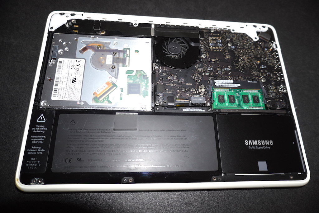

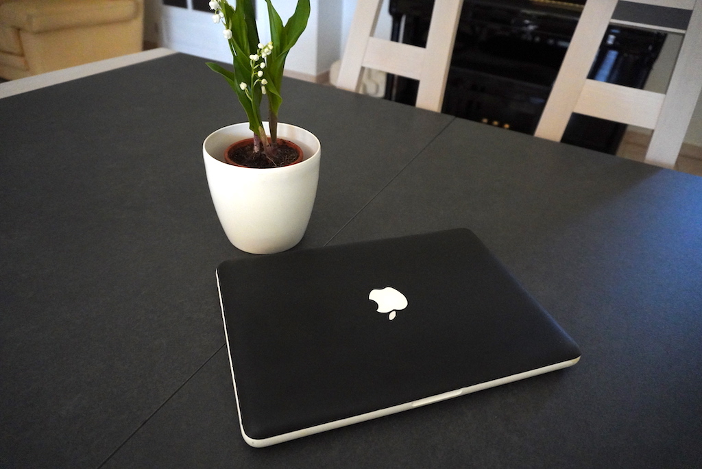

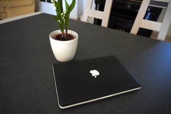

X) Logic board, fan and optical drive re-installed.
