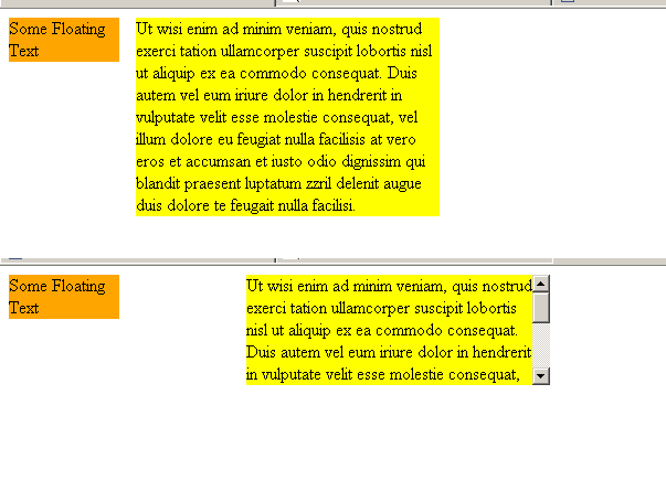

Never had a big problem with Firefox and thier CSS implementation until now.
the code on this page:
http://www.jimandkristene.com/snip1.html
is very similar to:
http://www.jimandkristene.com/snip2.html
The only difference is that I set it so the text will go in a scroll box, so I set the height and set overflow. There is a left margin on the text box so that it is next to the picture box without underneath it. Most browsers it looks ok.. or at least consistant. I don't have my Mac with me right now, but here's the way it goes in the browsers I have here.
IE4 - Margin is extra big, starting after the float.
IE5
IE5.5
IE6 - Renders the way I think it should.
Konquerer - Correct, but scrolling isn't impletment.
Firefox - looks fine in snip1.html, but snip2.html starts its margin after the float like IE4.
Attached it what it looks like for me in Firefox.
Top of the image is snip1, and the bottom is snip2.
Anybody know what's going on here? Is this officially a Firefox bug? I can't find any reference to it anywhere online. Or maybe I'm doing this whole thing backwards.

I never meant that I was using IE as any kind of marker for correct CSS display.. I just meant IE seemed to be doing, what made sense to me.
If I change the CSS of snip1 so the overflow is set to 'hidden' it acts just like snip2 in (what I think is) strange spacing. As long as I tell the height to be 'auto' it won't actually hide anything.
Now that I know how to get it to work consistant.. I can start figuring a solution.
http://www.jimandkristene.com/snip3.html
Does this mean the official standard for CSS holds that a float will go outside the margin of the next div instead of sitting on top of it?.. now that I think of it that way.. it makes more sense. :p
http://www.jimandkristene.com/snip4.html
I just made snip4.. now it looks good in IE and Gecko, but aweful in Konq. To Summarize what seems to be happening with a float and a standard div text box:
  • IE likes to put floats on top of all margins of other divs
  • Gecko puts floats on top of other margins, but not when overflow of the other div is visible.
So I put the margin on the float instead. Works good for these 2 browsers. But Konq likes to put the float on top of my other div.. Anybody know what's going on?

Huh, I'm puzzled (not that I still don't have tons to learn about CSS admittedly). It seems to hinge on the presence of a scrollbar - I tried it with "overflow: scrolling" and saw the exact same issue.
I may have spoken too soon in my first response; but it is odd that both Safari and Gecko do exactly the same thing.

Gave it a nice Doctype and Everything is valid.
It still looks bad in Konq. Is Konq's CSS Implementation just bad enough to keep it looking completely different than every other browser, or is it all my fault.
http://www.jimandkristene.com/snip5.html
Alright, I think this one will work the best for me.
This particular bounding box method will work for what I need, but I wonder if there is a better way. Right now, it's set up so there is a left float box, a right float box and a small div to sit at the bottom with the clear set to all... that way the bounding box is around all the text.
Can anybody come up with problems using this method? It's working with IE, Gecko and Konq. Does it look bad in anybody else's browsers?
I'll take care of the black box later.. but for now just making sure it works in all browsers.

Crud Crud Crud.
I forgot about the floats I used in the navigation on the right and left side of my site that this is for. So when I use "clear: both" it clears to where my navs on the side end.
I've been able to come up with quite a few awful hacks that would probably work, but I don't want to have to try to deal with that later. Should I just decide that Konq's implementation is flawed and go ahead and use "snip4" or can anybody come up with a good alternative?
