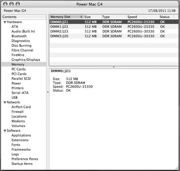

I've run Disc Utility, OnyX and DiscWarrior without anything major cropping up. My instincts (I've been troubleshooting Mac problems for 16 years) tell me that I have a fundamental hardware problem, possibly with one of the 4 RAM DIMMs installed.
The RAM configuration is shown in the attached screen grab.
I'm considering removing one DIMM, running with 1.5GB of RAM rather than 2GB for a while, and repeating with a different DIMM removed each time until I can hopefully isolate the dodgy DIMM.
Do people feel this is a sensible approach, or should I try something else first?
