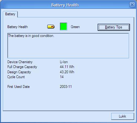

After I've owned three laptops with LiIon batteries, I beg to differ. With my first one, I did as told. I charged whenever I felt like it, and the battery lasted about a year. My second laptop I used on batteries until they run low. I did not manage to wear the battery out before I sold the machine, but the capacity was about 70% of the original after 7 months. My last machine has a spanik new 43,20Wh (design capacity) staminabattery. I use it on the battery every day, and let it run out every time. As I write this, the cycle count on the battery is 14, and max capacity is 44,11Wh!!! That is almost 1 Wh above design capacity.
As a proof, I'll attach an image of the battery health tab.
