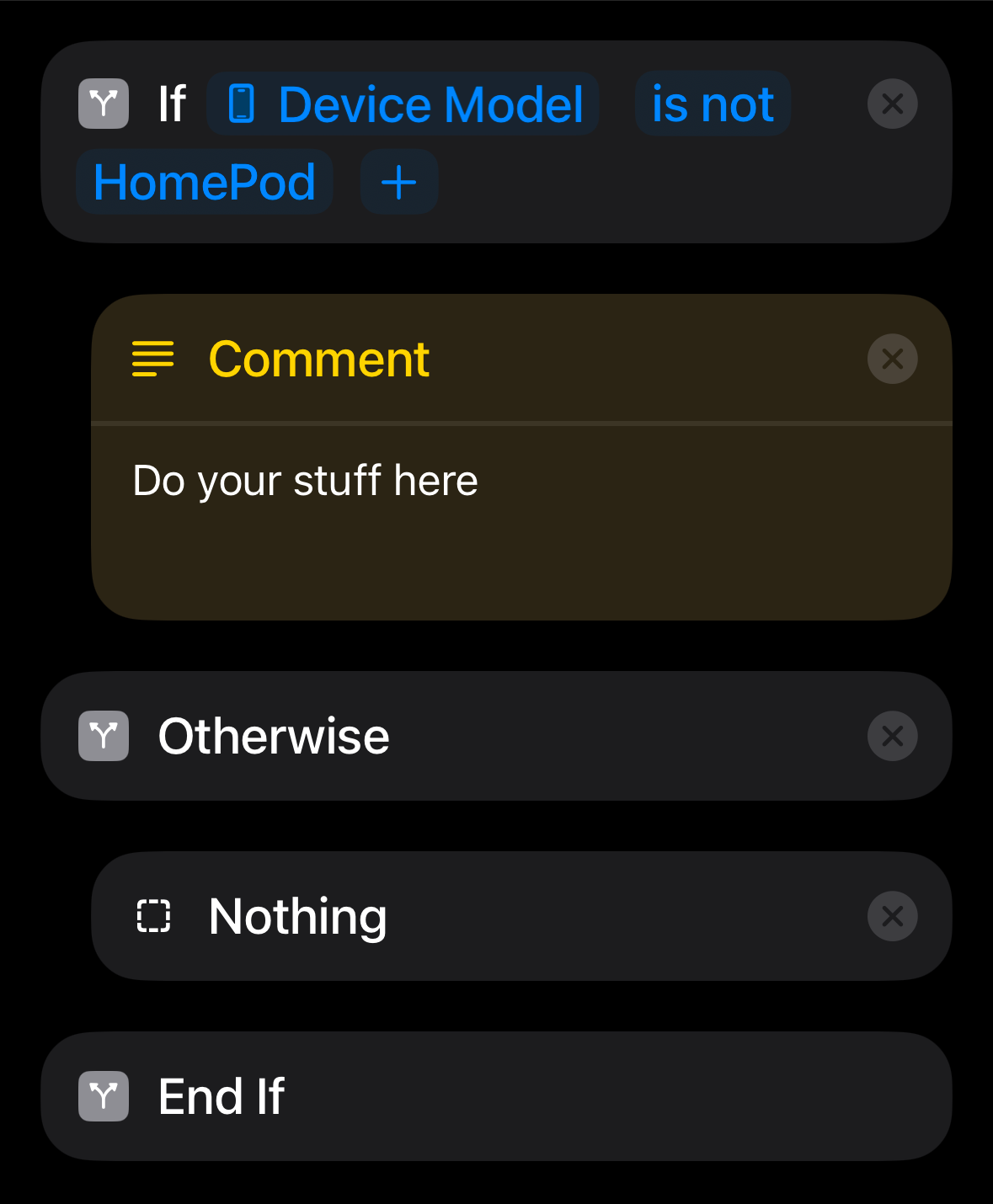

I’ve been thinking of getting a HomePod mini for my garage to replace the 30 year old shelf system that I play my iphone through. The issue I have is I have an ga door opener that I can open with a Siri command. Is there a way to shut that command off for one HomePod only?
You can't shut it off that I'm aware of, at least not with a simple toggle. You could modify the Siri Shortcut to check the Device Details of the device it's running on first, such as the Device Model or Device Name. Then do your stuff based on that. The example below uses the Device Model. With Device Name, you could restrict it to only run on certain devices (i.e. "omerbaker's iPhone").
Reactions: dotme
OP you don't mention if your opener is integrated into HomeKit. If it is, nobody should be able to use a HomePod to open a door - it should tell the person issuing the command to authenticate on their iPhone.
If the opener instead has its own app and is commanded via an iOS Siri Shortcut on your phone, I believe those require that "Personal Requests" be enabled on the HomePod or they won't run. You can turn Personal Requests off on individual HomePods, or roll the dice and hope voice recognition works and strangers can't run shortcuts on your iPhone. In that case, I like iStorm's answer as a safeguard as well. Hope this helps.
