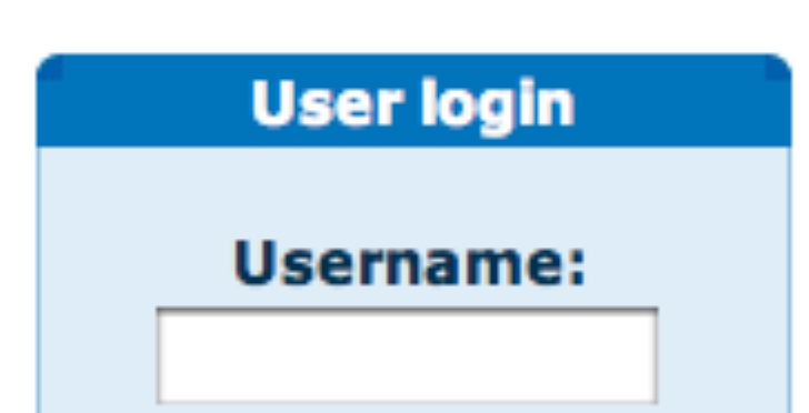

As a matter of fact, that site doesn't do it properly. You can see the corner images.
Thats strange. In your image, I can see the corner images, but at the actual site, and when I zoom in on a screenshot, I can't see them.
Here is the very same box zoomed in 500x (notice, no corner images can be seen):
Odd, it looks right in Gecko browsers and Mac IE, but I see the mismatched blue in Safari too.
They probably just used the wrong hex color for the table bg. It obviously doesn't match.
I believe it has to do with saving the file with the wrong (or was it without any) gamma settings. That is, if the image is a .png. I remember reading about that somewhere for PNG images. Other browsers assume no default gamma setting and Safari assumes the system default gamma setting. If I feel ambitious I will try to find the article I read about this in.
