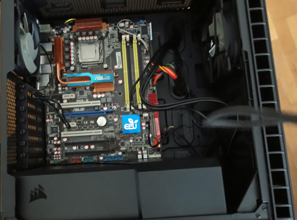

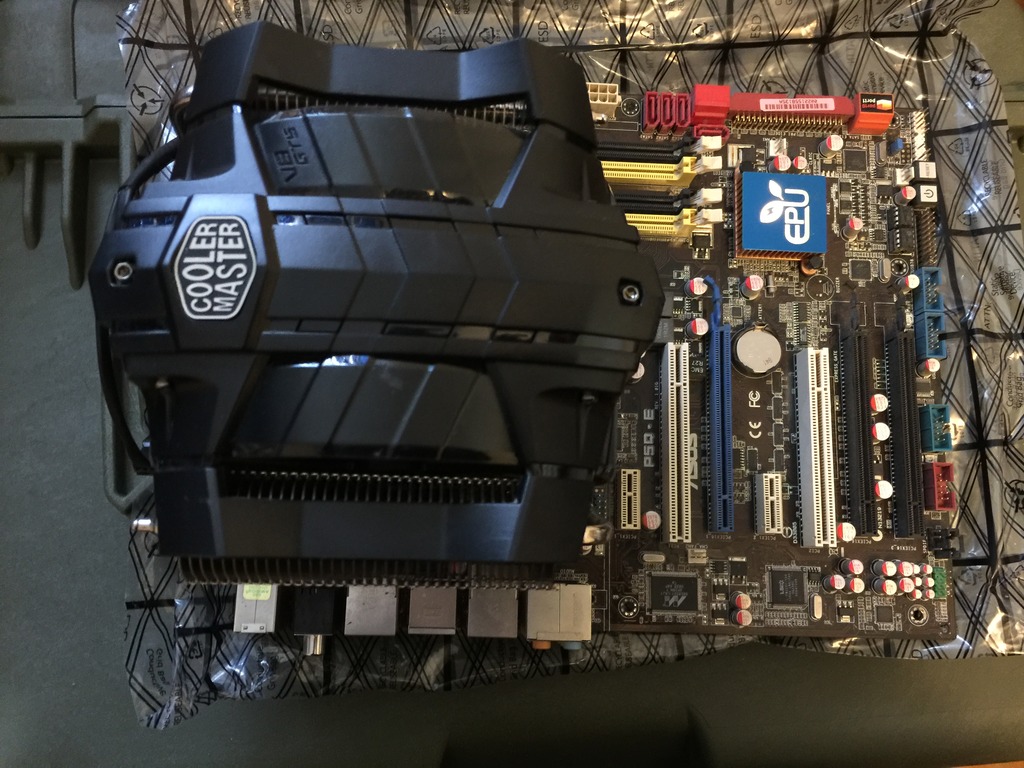

My Asus P5Q-E board arrived today. You can't see it in these but I will be using my Q9650 Core 2 Quad 3.0GHz processor in this build. Unfortunately I failed to realize that it didn't come with an IO shield so I placed an order for one today.
The case should be arriving tomorrow. :D

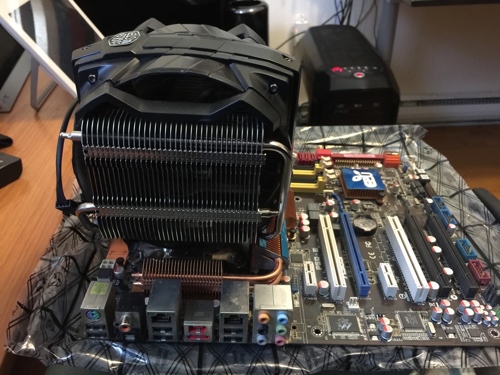

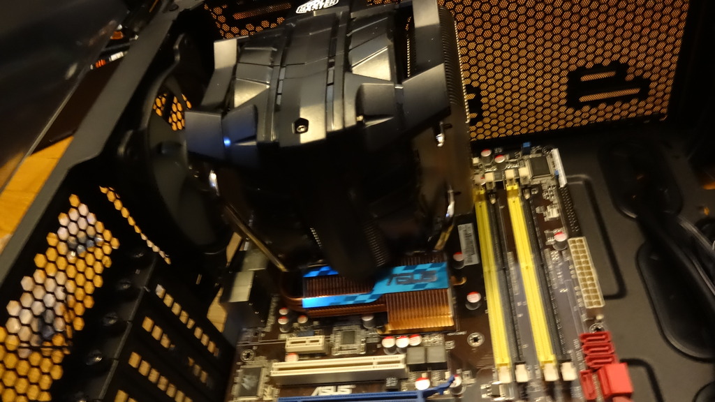

Here are a couple of photos of me testing fitting the Cooler master V8 GTS. No thermal grease has been applied yet and the cooler is not secured into place but that is essentially going to fit so I can reuse the cooler just like I was hoping.
Man, you need to take that motherboard to the doctor. It's got some kind of huge growth coming out of it!
wow, you practically have to overclock with that cooler.

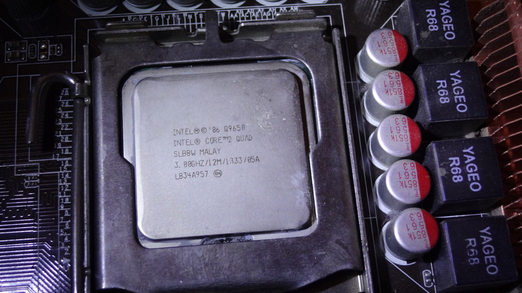

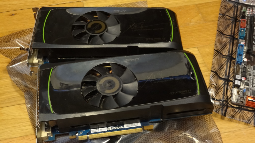

Here are the two graphics cards I intend to use. I realize SLI isn't a thing for macOS but if anyone knows please let me know if I need to use the SLI bridge to make use of the second card for things that use the CUDA cores.
This is the Core 2 Quad Q9650.

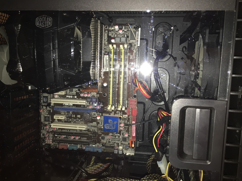

Here is the board and cooler test fitting into the case.

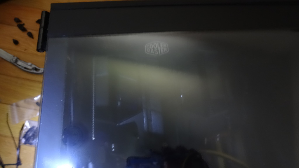

With the case door shut.
As far as I know, no, an SLI bridge is not needed to make use of CUDA on both GPUs in macOS.
The IO shield arrived today. Later tonight after I get off of work I'm going to assemble the machine.
It's not required in Linux. I had a few Tesla K80s and the CUDA drivers automagically used all cores across all cards, unless specifically directed at one card.
So it seems unanimous that I don't have to worry about putting a bridge in. I have a few but I have no intention of installing Windows on this machine so I won't bother.

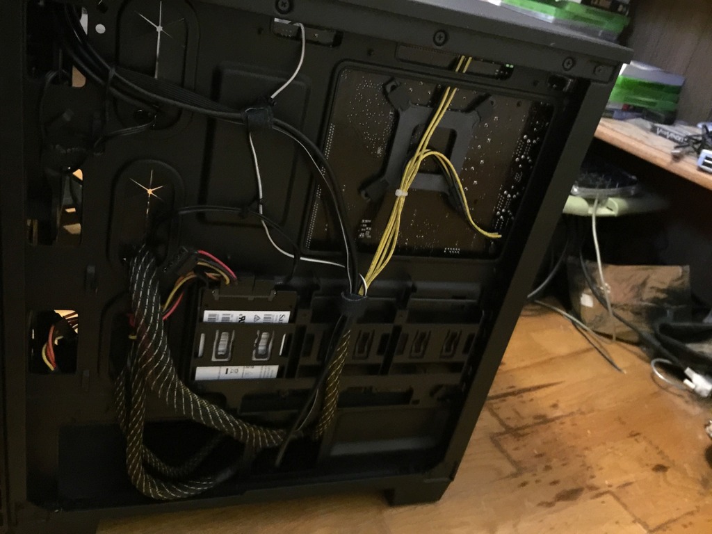

I have the power cables for the PSU routed behind the back of the motherboard trey. I still have to zip tie the cables into place to keep them from shifting around. I also have to get all the rest of the case and fan cables squared away.

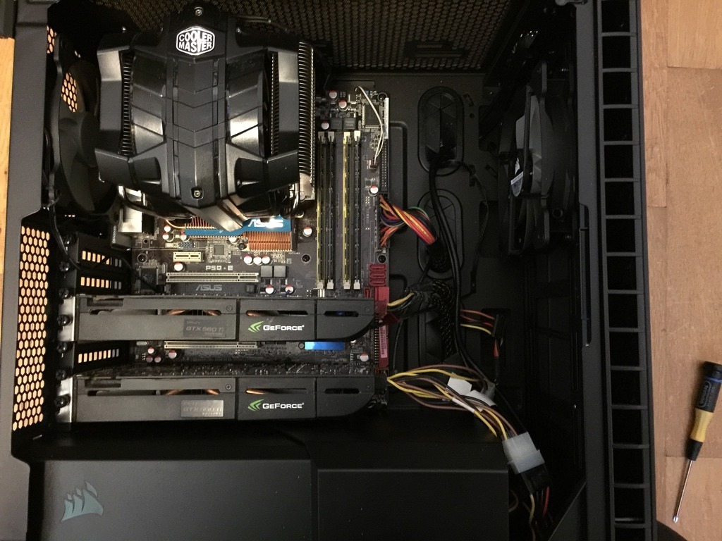

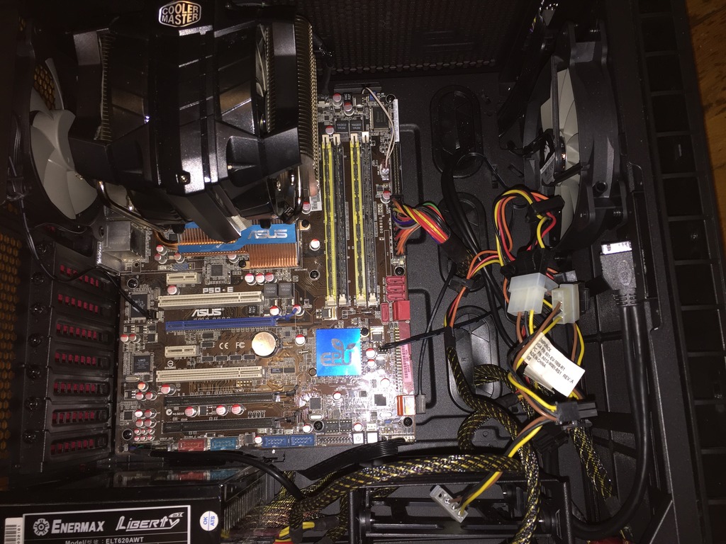

I finally got most of the computer assembled. I ran into major issues installing the Cooler Master V8 GTS for several reasons.
First the case is smaller and the top filter when off doesn't open up the top of the case entirely like my Corsair Graphite 780T.
Second unlike my ASUS P5N-D the ASUS P5Q-E has heat sinks surrounding the CPU socket which really became an obstruction even to my small fingers.
I ended up taking the motherboard back out and installing the Cooler Master V8 GTS. Then while positioning the board to go back into the case I had to plug in the 12V connector from the PSU into the board because of its short length and the fact that if I didn't the top of the case and the Cooler Master V8 GTS the connector would have been impossible to get plugged in.
Once done with finger yoga I got most of the wires secured and screwed the board back into place. The remaining wires to secure are the cables intended to power the graphics cards. Since this PSU is so small I'm using separate cables to provide power to each of the six pin connectors using two IDE power connectors to the connector for the graphics cards.
If the Hackintosh works I will consider pulling this PSU and put in a modern full modular PSU. For now though this will get it done.

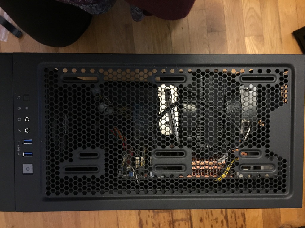

A little more work on the machine this morning before work. All I have left to do is a little more dressing of the cables in the back to secure the remaining power cables into place.
After work today I'll finish dressing the cables and this weekend I'll start the process of bringing this machine to life with either El Capitan or maybe Sierra if I'm lucky.
