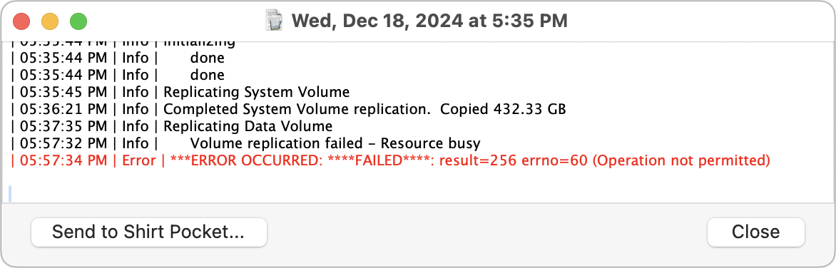

Off the top I like to create a bootable external clone for quick recovery should something go haywire while I am updating, testing new apps.... I'm running 15.1 and so far both CCC and SuperDuper have failed to produce a bootable clone. Was hoping to do this before running the 15.2 update. The apps say the clones were successful, but the drive does not appear when I do the hold the power switch boot. Nor are they shown as options in the Start-up disk panel. Thoughts would be appreciated. Running a new SSD on a Sata to Thunderbolt cable. Could Spotlight being disabled be a contributing factor?
According to your link the centre port is the DFU. Monitor is on the left port, SSD on the right. Tried CCC again, still no joy.
On further review, both apps create a non bootable clone. Supposedly you can recover from this but without being able to boot from it you are taking that entirely on faith, and you are looking at going through the Apple Installer if disaster strikes.

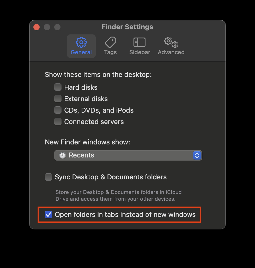

A question relating to leapfrogging about 7 versions of Mac OS.
In older system holding Command Key would let me open a new window while leaving current windows open. How do I do that now?

OP wrote:
"I'm running 15.1 and so far both CCC and SuperDuper have failed to produce a bootable clone."
That ain't gonna happen.
The era of bootable clones is ending (if it's not already over).
However, it IS still possible (for now) to boot from an external drive.
If you want something that is "close to a clone", do this:
- get an external USB3.1 gen2 SSD (or just USB3, if you already have one)
- install a fresh copy of the OS onto it (still a daunting process, sometimes it goes through easily, other times not)
- now, during setup, "migrate" the contents of your internal SSD to the newly-created external boot drive.
The result will be "like a clone". At least "when brand-new".
However, you won't be able to use either CCC or SuperDuper to "update" it.
If you do that, it may be rendered un-bootable again.
No use complaining.
It's "just the way it is now".
Welcome to the world of Apple Silicon, and the ongoing transformation of "the Mac OS" into "the Mac iOS" ...

Yeaah I get that, What you are describing is the OS 15 step waltz. Why do something in a single step when you can do it in 15? Must be a nightmare for those who have to update a huge bunch of computers.
Bottom line restoring the internal to the state of the external requires the entire install process rather than a clone back, orders of magnitude longer. Generally once I had the external up and running I would use SuperDuper to create an ASR disk image of the internal. Then in the event of disaster would boot from the external and use the asr command in Terminal to restore the internal drive from the asr disk image. With the MacPro running the back-up drives internally that restore takes less than 5 minutes.
For the moment I won't do any further Sequoia system updates until either this is resolved or Apple goes on to the next system of bells and whistles. Will download the current full installer so at least it's on hand.
Solved this one. The tabs in open windows are not at all obvious, but you can drag a tab to the desktop to get both windows open at the same time. An extra step, but at least it's just one step. Will do another settings dive to see if I can kill that particular whistle.
EDIT: Could not find a way to disable window tabs

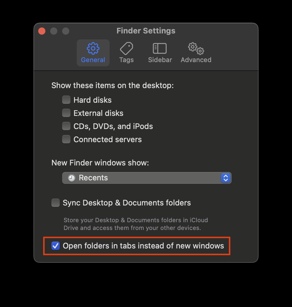

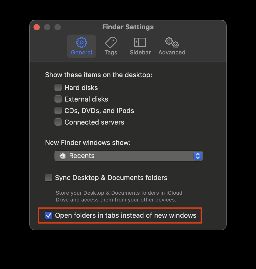

Finder -> Finder (menu) -> Settings… -> General (tab)
Thanks, :)
I spent some time in system settings with no joy at all. Your post resolved the issue with a single click.
