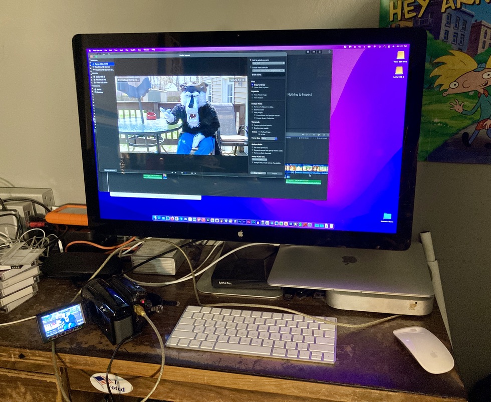

Or just the TB2 <> FW adapter (with the additional TB3 <> TB2 adapter for newer Mac models)? It works just great with FW video sources like my Sony D8 camera on all kinds of MacBooks (used on even my 16" 2021).
Reactions: dandeco
Oh yes! That's what I still do, complete with daisy-chaining the adapters, or using the FireWire port on my Apple Thunderbolt display, and it gets the job done nicely, hooking a VCR to one of my DV camcorders that supports analog passthrough. On my Canons that do so (HV40 and Optura 60), I can only do it with non-copy protected VHS tapes (at least that includes home recordings from television), though if I need to import footage from a commercial VHS for, say, a YouTube Poop (like the one I did of Disney's "Aladdin" three years ago) I use my Sony DCR-TRV460 Digital8 camcorder that I also use for digitizing my Hi8 tapes.
The setup with my Canon HV40 importing standard-def MiniDV footage, testing the fixed FireWire video capture on Mac OS Monterey 12.4. It does seem more fun to do that using a USB video converter like Elgato, though I know somewhere down the line I may need to resort to that.
