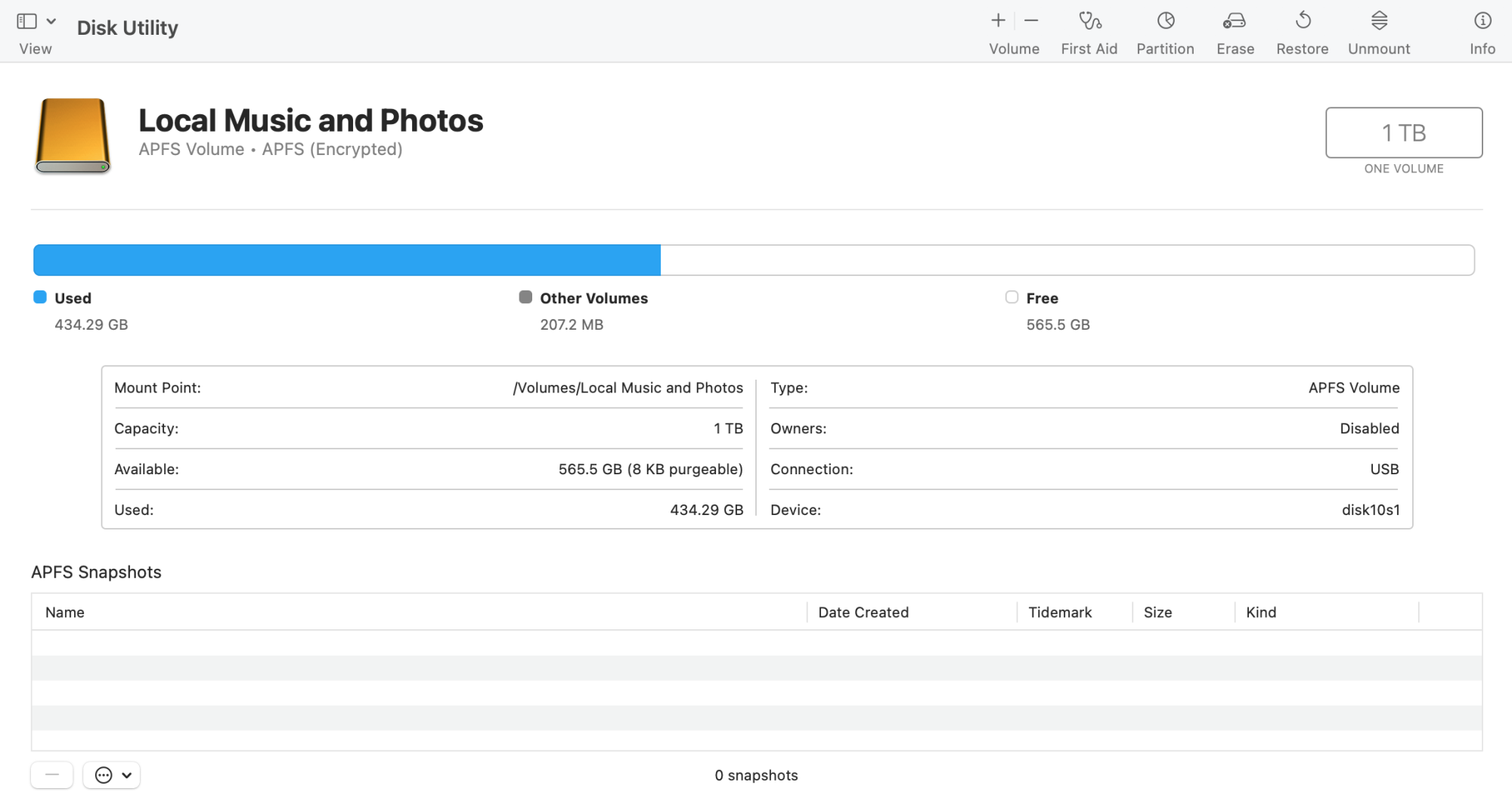

Disk Utility, or File Info from the Finder, both show the disk as being full (only 10GB available), however:
- Finder shows only 600GB of data (including any and all hidden files and folders).
- There are NO local snapshots. I've deleted them using Disk Utility, and restarted the Mac.
- The Recycle Bin is empty.
- There are no additional or hidden Volumes nor VMs on this disk.
- The data on the disk consists of Photos and music files, including the Mac Photos library.
- I've unmounted the disk and run First Aid successfully.
- There is no amount of purgeable data of significance (3.65GB)

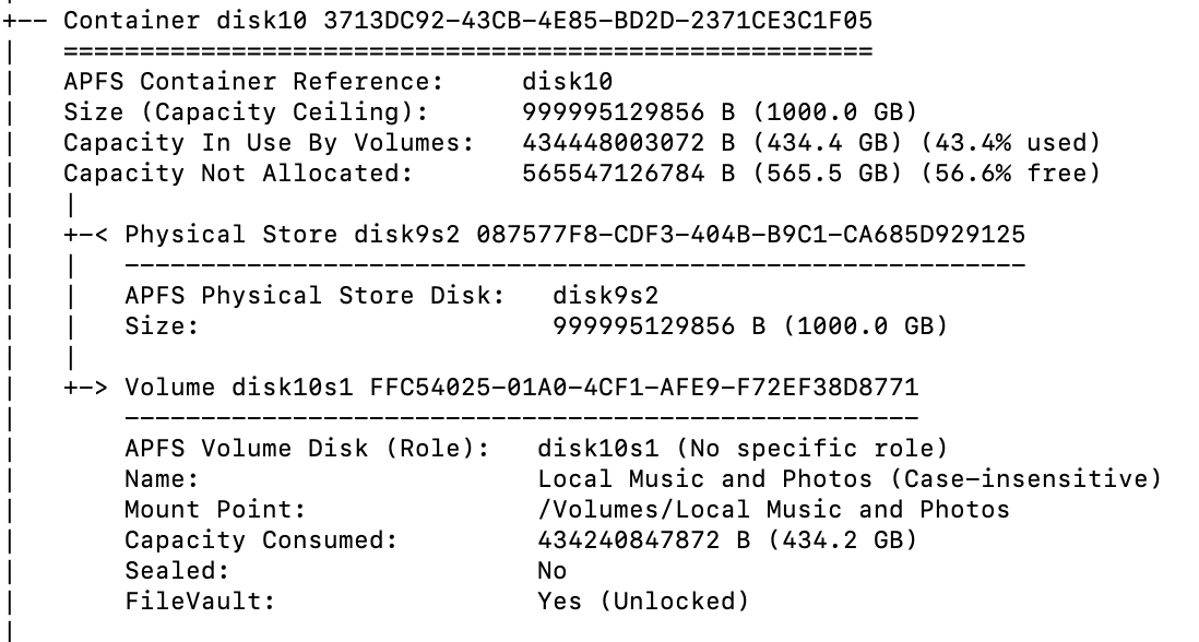

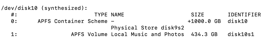

Update: I have moved all of the visible data onto another disk and the SSD now still shows as having 434GB used space.
I cannot see anything at all in it with the Finder, including hidden files.
Still no snapshots and no purgeable data.
I am stumped.
EDIT: Daisydisk marks the space as Hidden, but it is unable to establish what's in it, if anything.
I am starting to think this is due to some kind of corruption, even though First Aid is not picking up anything wrong.
