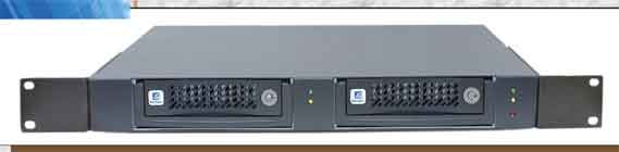

Firewire 800 with dual seagate barracuda in removable drive bays.
