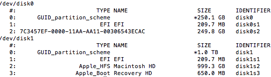

I have a 2012 mac mini with a 250GB SSD and a 1 TB HD, both internal. I was using the SSD to boot but then it wouldn't boot so I did an internet recovery and Mavericks was installed on the the 1 TB HD. Now I can't see the SSD in finder. It is in disk utility which lists it as a 250 GB disk with a nested disk called disk0s2 (which is greyed out). I ran verify disk and repair disk on the SSD and it checked out fine. The disk0s2 is greyed out so I can't do anything with it and it won't mount either. So how can I get this SSD to be my working boot again? Thanks

The SSD had catalina on it, which I now have on the other drive too. I tried all the operations in disk utility but they all failed.
I ran first aid and the operation failed: The partition map needs to be repaired because there’s a problem with the EFI system partition’s file system. : (-69766)
I tried partition and it failed: Couldn’t modify partition map. : (-69874)
I tried to erase it and it failed: Wiping volume data to prevent future accidental probing failed. : (-69825)

I took the disc out and it loaded in an external enclosure and I was able to use disc utility. I wiped it and put it back in and now it works. I noticed problems starting after downloading the latest Catalina and I am wondering if it somehow corrupted the drive.
