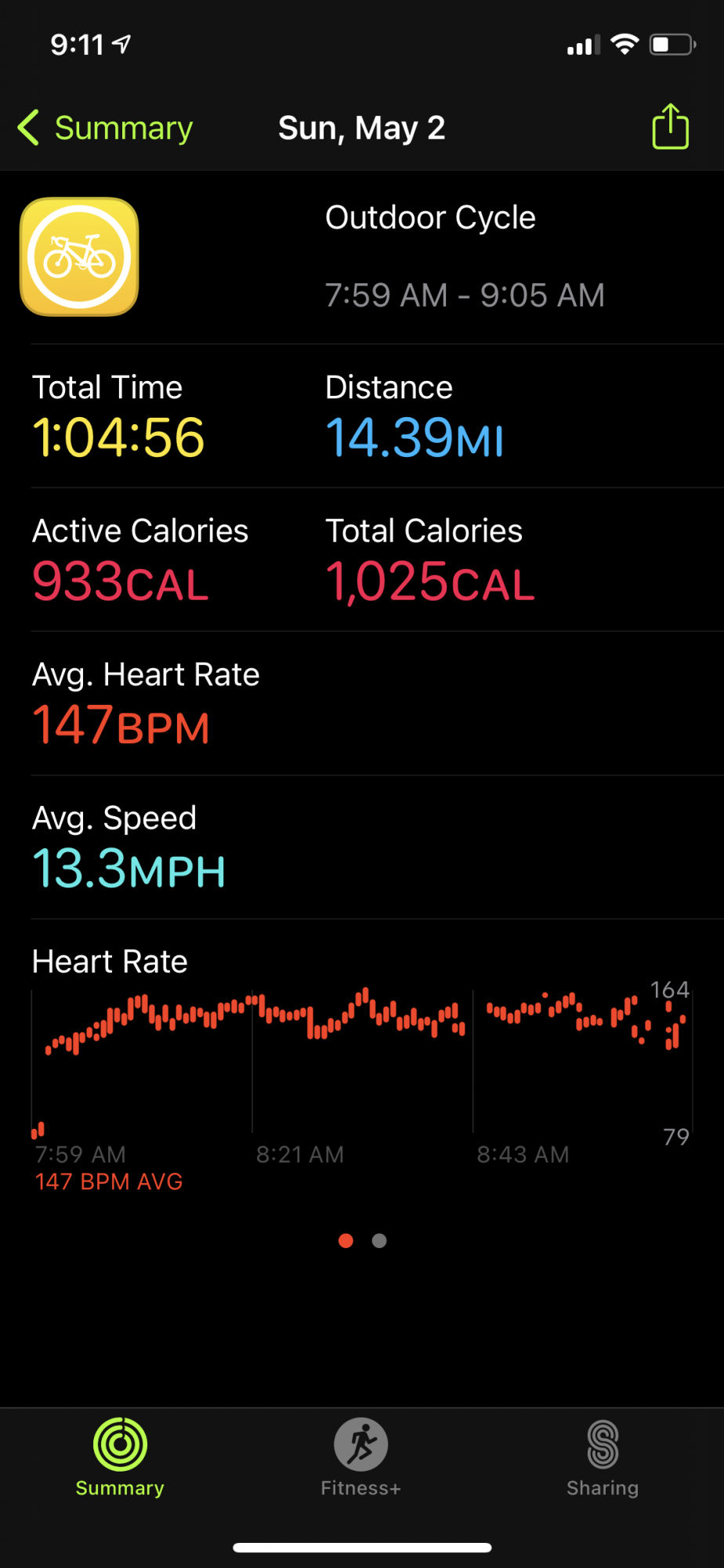

I've been noticing about 40 minutes into my cycling workouts the heart rate monitoring seems to just stop. Example here from yesterday where about 40 minutes into the workout it stopped reading my heart rate for about 5 minutes (I can tell when it stops because my calories burned stops increasing). You can see the gap in the heart rate readings. It seems if I manually start a heart rate reading on the watch, it will resume monitoring, but it's hit or miss and I may have to do that repeatedly every few minutes to keep the heart rate monitoring going.
Another example from this morning (right around the 8:43 AM mark) where it stopped reading my heart rate for a few minutes and I jump started it by initiating a heart rate reading on the watch. You can also see how spotty the readings are thereafter compared to prior to that point. Anybody else notice anything like this?
I had similar HR dropout issues on my daily runs both with my current Series 6 and the Series 3 it replaced. I was using the sport band that came with the watch.
I switched to a sport loop band about a year ago. I wear the sport loop about a half inch above my wrist and attach it snugly.
I haven't experienced a single HR dropout since.

Yep...have experienced this for years. Have not found a real solution but what sometimes works (as found on the forums here) is to check your HR 2 or 3 times prior to an exercise / workout or run. But this appears to be a well known problem. Or feature!

My experience exactly during running and brisk walking. It's even more evident after the WatchOS 7.5 update a few days ago. Adjusting tightness and placement on the wrist doesn't make a difference; neither does a reset. This is the only annoyance I've had with the AW6 but I sure wish Apple would improve the performance of this pretty important feature.

I have this too on my AW4. Especially if I'm not properly hydrated. I've definitely seen a correlation between heart rate issues on AW and how hydrated I am.

I gave up trying to find a solution for this. I was first in contact with Apple for TWO MONTHS and did everything possible softwarewise: unpaired, restored watch, restored iphone, paired with another iphone...NOTHING. I pushed and they swapped it and the same thing. My wife has one and it is the same. It is just during running or brisk walks and I am now 100% sure it is a hardware issue. They will never admitted because it would mean a call back and they tried everything to put it on me: the temperature outside, the band, the position on the hand. I have tried everything band that I have loop or no loop and wear it up to my elbow :)...NOTHING. It is a hardware issue.
There are people complaining about it. I also need to say that optical sensors will never cope with speeds. A guy from Apple support told me that Apple Watch is for people that want to stay active but if you want professional readings we should get a chest strap.

I'm sorry I don't have any helpful information for your specific issue which, while I no longer share, I do understand. When I was having measurement dropouts mid-run it was extremely annoying.
I was surprised to read that different bands and even a replacement watch didn't fix it for you. As mentioned a tighter fitting band slightly higher on the wrist fixed it for me. I do hope you get it resolved.

My AW4 does the same thing. I start a walk and first 1-5 minutes nothing (it shows an outline of the previously recored BPM readings). On my bike rides, I see usually 1-2 gaps throughout the workouts.
when I see this issue I usually try to open the heart rate app and see if that starts reading my heart rate. Sometimes it works, sometimes I end up with a heart outline and an icon inside of it.
I had similar issues as those above with the series 4 watch. The solution for me was to switch to my other wrist. I am (wildly) guessing that the skin on my right wrist is somehow different then the left. It could be that the skin under the watch is much less tanned on the left (my normal wearing wrist) versus my right. I am a white male with pretty tanned skin. Not saying this is the solution for everyone but it works 100% for me.

I wear a tight solo band for exercise, I’ve never had any problems with the fitness app tracking my heartbeats in real time. And I don’t think melanin (pheomelanin/eumelanin) are factors in the lack of tracking. I’ve read that tattooed skin will definitely create a sensor barrier due to the non-human pigments and density of applied pigmentation. I also sweat a lot during cardio, and as long as I am wearing a tight band, there’s no problem with the sensors.
