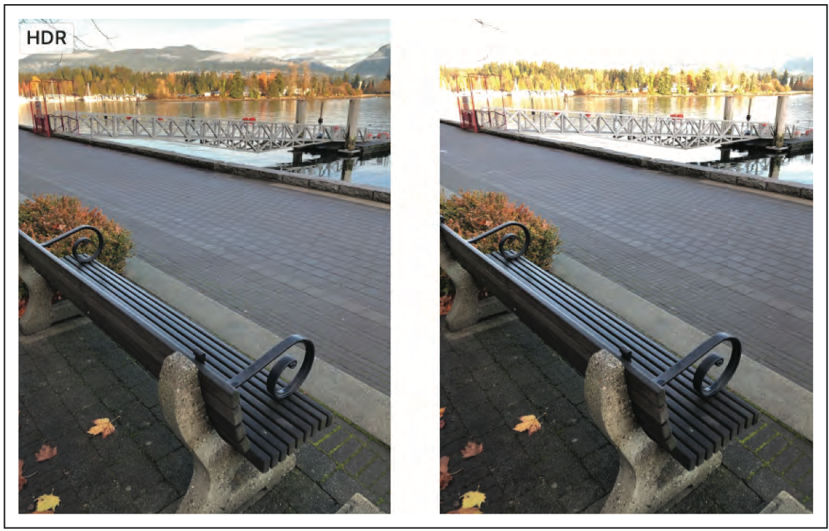

This doesn't apply to the OP however for people that stumble through. More often than not when luminance is measured across the screens entirety HDR will but "darker" because people use too high of a brightness setting before and not even noticing the massive amounts of clipping (1st reason its dark).
Here is an example, the HDR on the left is darker...but only where it helps. You couldn't even see there was a mountain back there before.

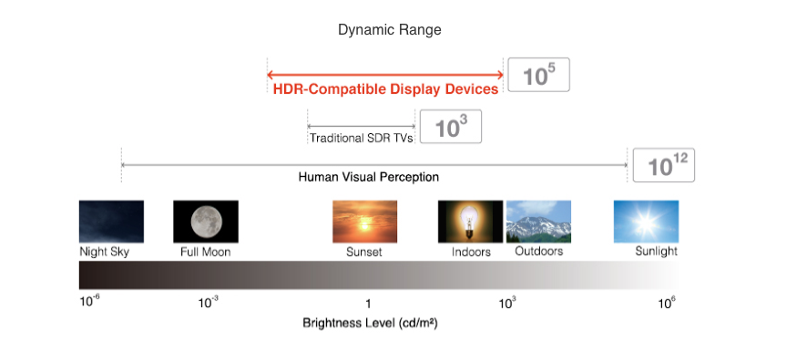

However the main reason people turn on HDR say...its too dark and washed out and then turn it back off is because they switch color spaces (SDR Rec 709 to HDR Rec 2020) but didn't bother to adjust the TV settings for the color space and dynamic range. Here is why you need to do that....
Not representative of perceived brightness but thats 100x higher range for brightness of brightness for HDR. If you limit the peak brightness to the SDR range its going to be very dark. (2nd reason its dark)
