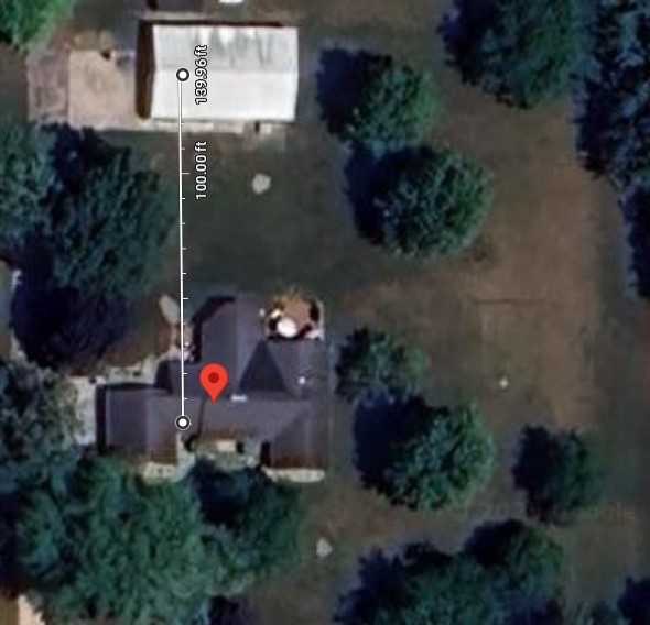

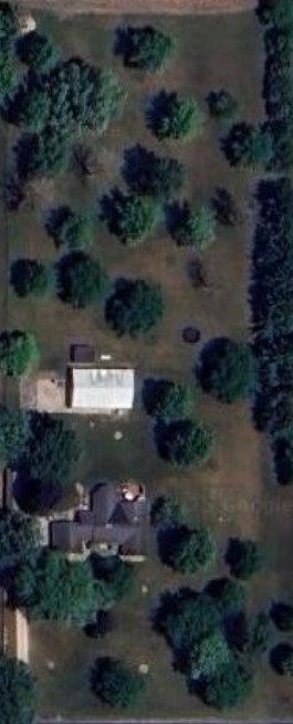

Anyway, I get service everywhere in the house, and across a good portion of my yard outside (4 acres). However, I have a 36'x64' shed with metal siding/doors/roof and get no service inside at all. I have good Verizon 5G service, as well as good WiFi signal standing outside, but as soon as I go inside I have no service at all. I know the best solution is to run ethernet, and I plan to do that eventually. I have a water line running to the shed that has a leak, so when I dig that up to replace it I will probably bury ethernet and coax in the same trench and then I'll have internet and DirecTV in the shed I can use. We are saving up to do that, but it might take a year or so before it happens. Here is an aerial view showing the approximate distance I am dealing with. About 120 feet from my router to the door to the shed, 155-160 feet to the far wall of the shed.
