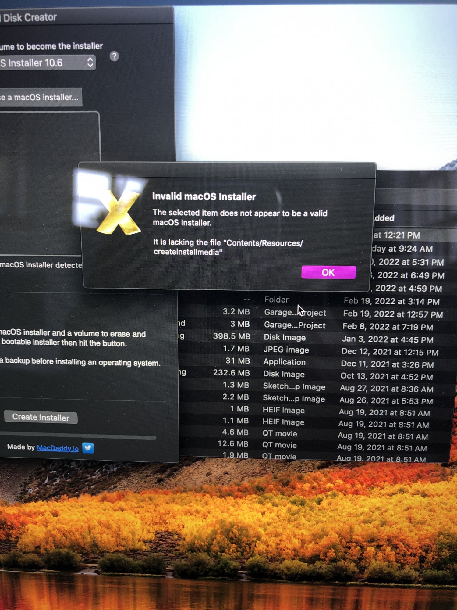

I got one of the apps that you recommended, and i got the InstallMacOSX.dmg El Capitan installer, and I selected my USB drive (64GB) and it gave me this error, tried using the .pkg version too and it gave the same error
