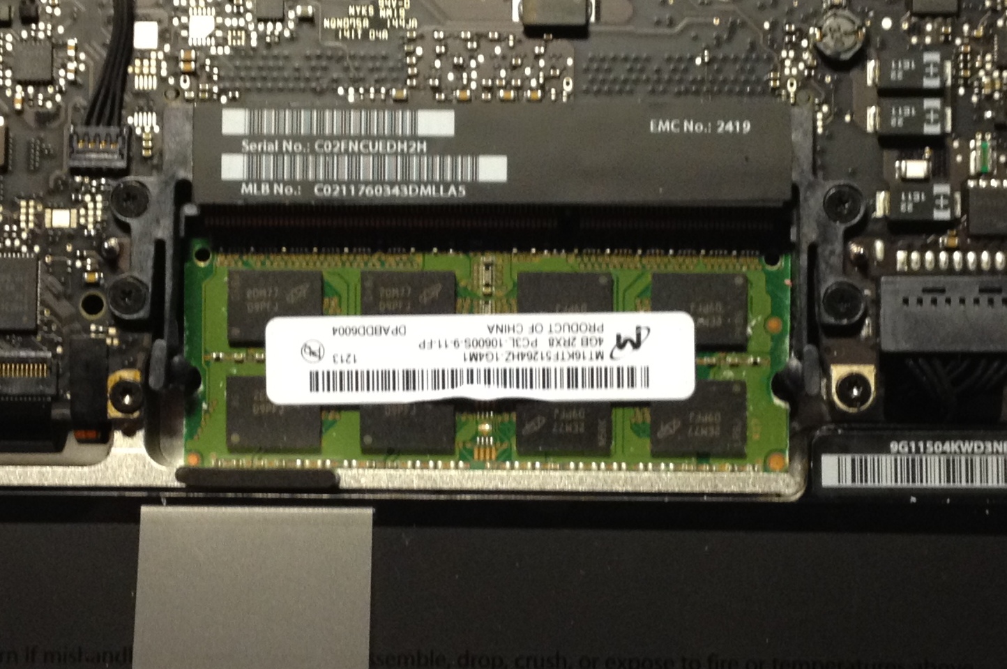

Thank you for your reply, would you please do one more favor for me?
I have attached a picture of my macbook pro memory module and would like to know the location of "second recessed joint on the plastic". if you could just point to it, I will appreciate it.

Well. Looking at this it does not appear to have my expected "indents" no matter. Apply equal pressure "out" around this area it should move up only slightly. Then pull out toward you (up and out). Try ifixit.com for actual picks of memory installs if this is too imaginative for your liking. Also kind of looks like it is stuck under the front plate. If this is the case push it back in and then back out.

you are right, it is stuck under the front plate, well stuck, I have changed memory before, but this is the worst. I thank you for all your help, I will try your suggestions. if you have any other ideas or other advise, all are welcome.

How strong are your fingernails? You may be able to use your thumbnail on a black memory square to push it back in so you can release it upwards. Needle nose pliers, flat head screwdriver, all ESD safe, of course.
I finally did it with a picture hanging bracket, I want to thank you for all your suggestions, it is people like you that encourage people like me to do what seemed impossible.
