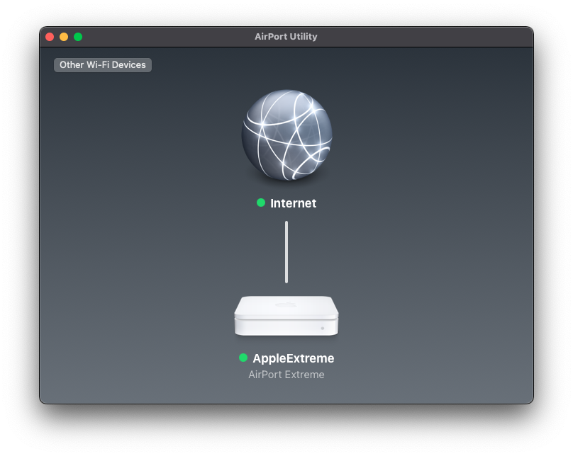

I'm using a couple Express's with an old Airport Extreme as a router. It took several restarts of the Extreme to finally work, but so far seems to be OK. I already had the local network set up before upgrading to Big Sur, which is probably the only reason it is currently working. The Extreme is connected to my cable modem. But you're right, the Big Sur Airport Utility doesn't offer any obvious way to configure the system.
I did notice that after opening the Airport Utility several times, the Extreme suddenly starting connecting. In the Preferences there is an option to "Check for Updates when opening". Perhaps there was some type of update that took place, but once connected, you can click on the device and edit the settings. Not a great situation for these legacy devices that don't have a good substitute, especially for connecting to your music system.

I had the same problem with my AirPort Extreme (10-12 years old) with the last macOS upgrade or two. It just would not appear in the AirPort Utility on any of my Macs. I reset the AirPort Extreme with paper clip in the reset hole on the back of the device and it immediately popped up on the Airport Utility and I was able to configure everything back to normal. The AirPort Extreme had the latest version of firmware available for it before I had the issue.
