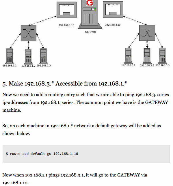

Thank you for the detailed post! Sorry for not explaining the setup properly. I simply want to connect 3 computers--no internet, no hubs, base stations, etc. So imagine a clean slate, and here is the question:
Hardware: 3 computers, 1 ethernet cable
Mission: connect them together
I was able read enough about networking to get it working. It was fun to learn new stuff and put existing hardware to work. Now I can ping any of the 3 computers from each other. I can VNC between them, and importantly I can watch movies from the desktop RAID without wires, while on the couch.
This piece of an article was helpful, as it explained how to get subnets talking and how a gateway works:
Ok, I understand now. Only three computers without internet access.
Of course, simplest ( from configuration point of view ) solution is connect all three to small ethernet switch and use one network: address 192.168.1.1, 192.168.1.2 and 192.168.1.3. Default gateway is not needed, as there is no other network.
If you can use only this three computers without switch, it is also possible with two networks.
In you configuration from post #5 I changed IP adresses and you should have:
on G4 desktop:
IP address: 192.168.0.2
ip route add 192.168.1.0/24 via 192.168.0.1
... it says that other network with address 192.168.1.0 is somewhere behind Mac Mini (192.168.0.1) and send all it's traffic here
Mac mini:
cable ethernet IP address: 192.168.0.1
wifi IP address: 192.168.1.1
Mac Mini should act as router. Both networks 192.168.0.0 and 192.168.1.0 are directy visible from Mini, so there is no need for ip route add. But we must enable packet forwarding between interfaces. In linux we can do it with setting /proc/sys/net/ipv4/ip_forward value to 1.
In MacOS X I am not sure, you have to use google, but you can try both settings "Internet Sharing" and "computer-to-computer". In any case, there will be shell analogue to linux command.
I found on web for MacOS X sysctl -w net.inet.ip.forwarding=1, but you should try if it is works.
You also take a look to your firewall rules, but if you not touch it, default state should work.
