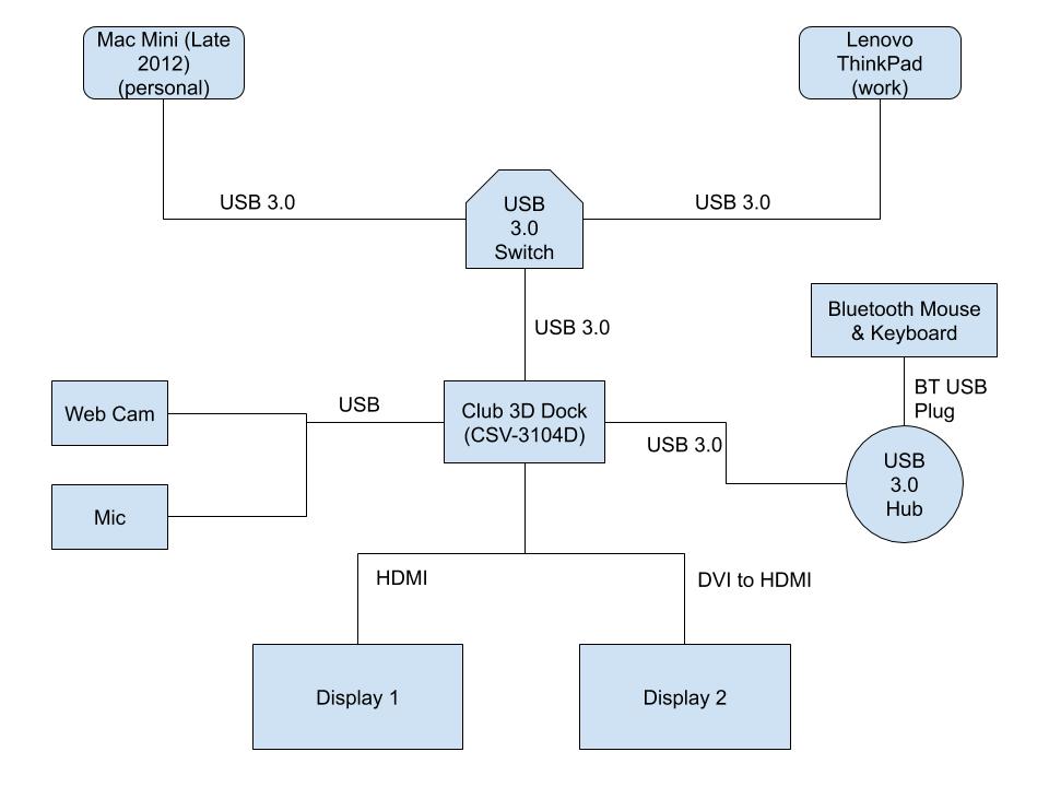

I want a quick and easy solution to switch between sources. In order to do so, I would need to make sure that all the peripherals are connected to the dock and not either computer. My thought was that if I get a 2-1 USB 3 switch (NOT SPLITTER OR HUB) I should be able to quickly switch between the permanent USB 3 connection on the mac mini and the desktop USB 3 plug for my windows laptop. The laptop needs to stay portable as I sometimes travel for work and am planning on hiding the mac mini under my desk to keep a clean look on the desk top (ironically my windows desktop is a disaster right now). So this leads me to issue #2…
Issue #2:
Does anyone have experience using a USB switch between the computer and the dock? I haven’t found one yet to test, although it would be something similar to this
https://www.amazon.ca/StarTech-com-USB221SS-Peripheral-Powered-Sharing/dp/B00DNULHHY

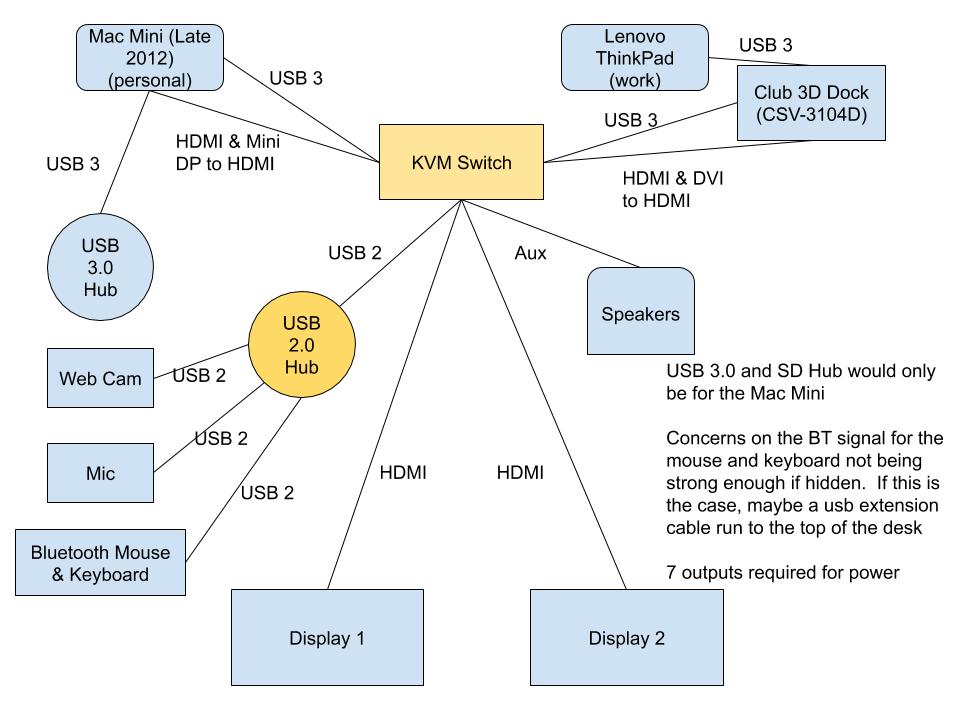

For reference, I’ve included a drawing of what I imagined the end result will look like if everything works.

For anyone that might look at this in the future, this is the correct solution.
You still need a docking station if you are planning on using a laptop or any device that only has a single display output.
Essentially you take the KVM 2x2 dual monitor KVM switch and run the mini dp, hdmi, and USB connection from the mac mini to the KVM switch. The laptop is connected to the docking station via USB 3.0 and then from there the hdmi outputs (one is dvi to hdmi adapted) and a USB cable to the same KVM switch.
The peripherals need to be connected to the KVM switch and not the laptop dock, this (at least in my situation) also requires a USB hub. Note; the KVM switch is a USB 2.0 so if you are planning on running external storage through this I wouldn't recommend it. I am planning external storage so the best solution I could come up with was to connect a USB 3.0 + SD hub directly to the Mac Mini as that is where I will need to connect the external storage to 99% of the time. For the other 1% of the time I figured the modular piece of the setup (the lenovo laptop) which is not connected for external storage will be easily accessible so I would simply have to plug my external storage into the laptop rather than the USB 3.0 hub that I'll have.
For me this solution is as close to perfect as I can think of. I should easily be able to get 1080p on both displays with both devices and easily be able to switch between them without needing manually reconnect all my peripherals.
As a bonus, I also have a (now old) PS4 Pro kicking around and am debating using a HDMI switch so that if I really wanted to I could also use this setup to game on a single monitor while the other one is used for either computer, I could probably find a different KVM switch to give me a third input, but I figured this would be overkill and I don't want any gaming experience to have a gap in the center where the dual monitors split, ie, one monitor is better for gaming.
As a final final thought; I don't think the Mac Mini works with the dock because it wasn't designed to. The computer has 2 display outputs already so it wouldn't require a dock conventionally and my assumption is that the USB ports on the Mac Mini are unable to transfer display information. Maybe a driver could open this up or who knows, but the conclusion that I reached is that you would never use a dock unless you are using a laptop so a desktop computer (be it PC or Mac) is unlikely to work with a dock for transferring display data over USB when there is a HDMI, display port, DVI, VGA, etc connections available.
That is the setup I have - an M1 mini and a Dell XPS tower sharing dual monitors, keyboard, mouse with a KVM. Works *pretty* well. I've had a few screen blackouts here and there so it's not perfect. My diagram is not as nice as yours!
Why have the displays connected to the KVM? The displays have multiple inputs. For keyboard/other low speed physical peripheral I agree, but simply connect the screens to each computer physically using different inputs.
