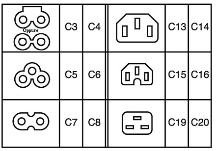

these 'figure 8' connectors are IEC C7 connectors. here are the different sizes/names:
C7
C7 (polarized - with square side)
if you can't find longer cords online, you can also look under "printer power cords" or IEC C7 cable for similar long reach cords. They are standardized and rated to 250V/2.5A (worldwide) and 125v/10amps in US (way more than HomePod would draw)
