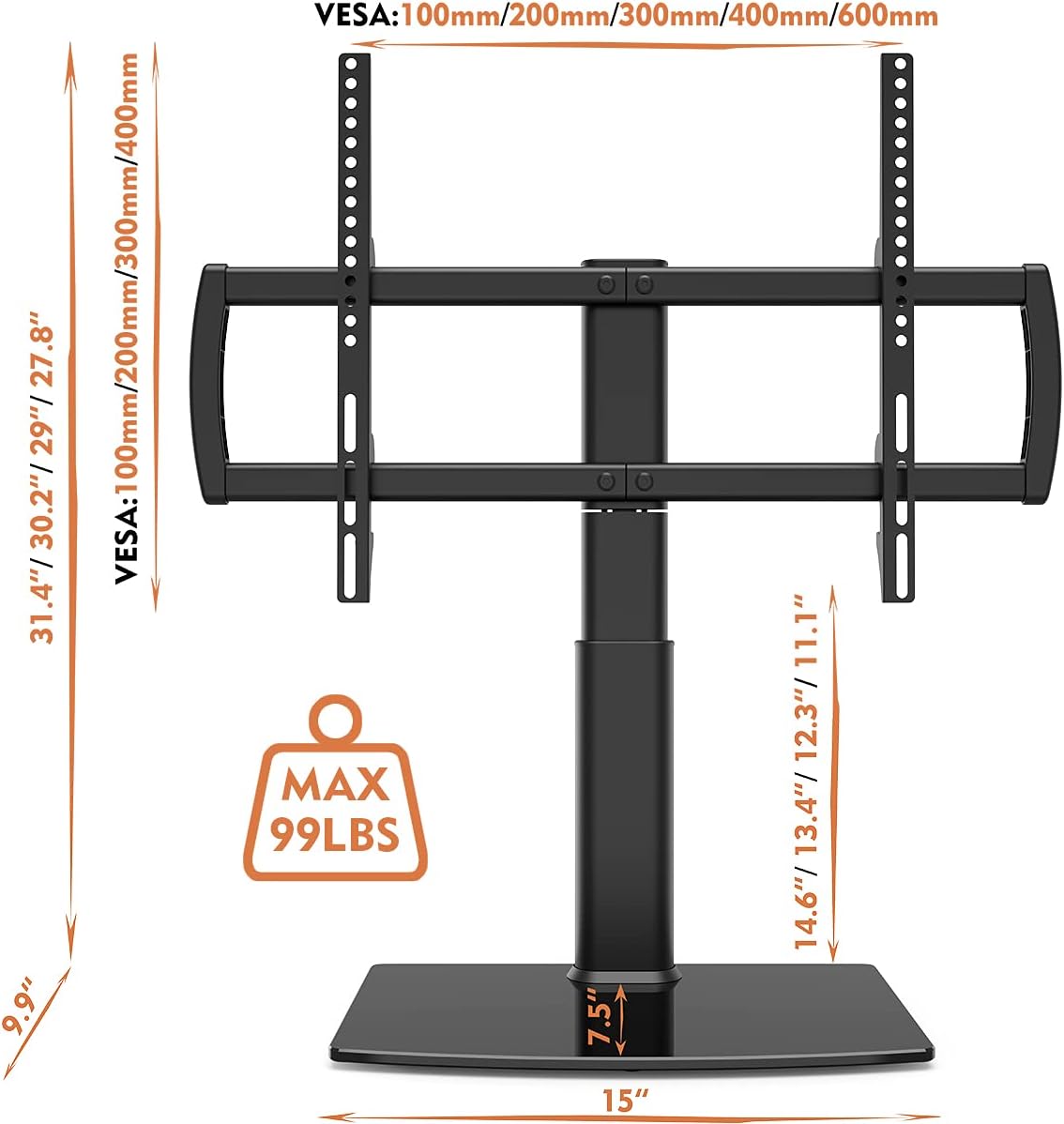

You might also opt to buy yourself a booster/riser for the TV mount to raise it a few inches to fit a soundbar in front of the screen without blocking the bottom of that picture. A dirt-cheap option would be to hit Home Depot or similar and buy some tile/brick/etc or similar to get the extra height you seek, and soundbar in front of it would hide it.
There's dedicated risers of many types/colors/heights for such purposes like this one...
That C1 probably has VESA mount, so you could also just replace the default stand with an off-the-shelf alternative that will let you choose the height you desire like this one...
