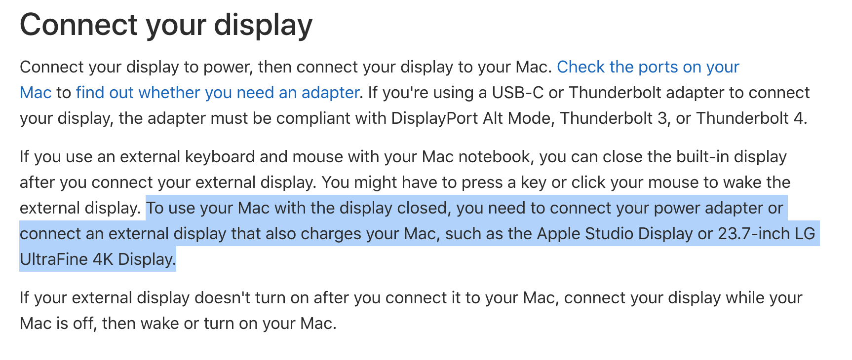

Officially, however, the answer is no:
You might want to google "use mac in clamshell mode without power" to see if there are any workarounds.
