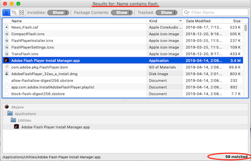

Or DEVONtechnologies' Easy Find. It is free

easyfind is fast and furious here on mojave (on both of my macs); version 4.9.3...
EDIT: just tried 'findanyfile'; somewhat faster than easyfind; i searched for a word ("london"); findanyfile found 14 items, easyfind found 16...
faf is somewhat faster, $6 more (easyfind is free); so, maybe easyfind is a good place to start...

You are correct that it hasn't been updated in a while, but, I don't have the same performance issues that you do. EasyFind worked great in HS and is working great in Mojave on APFS, for me.
