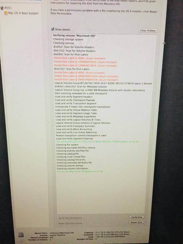

I believe my HDD in my Fusion Drive is bad, I have booted into recovery and internet recover mode many times. Attempted to repair volume and it said volume appears to be okay. But everytime I perform a repair I see red messages reporting errors. I have even tried to erase the drive and reinstall the OS several times with it failing on me at the very end. So I believe there's something wrong with my drive. I'm not sure if its my SSD or HDD or both. Can you guys tell from this pic?
It's the hard drive
SketchyClown, that's what I was doing in that screenshot. Everytime I run a verify/repair in recovery mode, it gives me those errors.
@212rikanmofo are you familiar with using the Terminal? Do you know how to delete & recreate a fresh Fusion Drive? Because the Disk Utility will not recreate it for you. The screenshot shows cksum mismatches for both the SSD & HDD portions of the Fusion so it may boil down to a somewhat corrupted coreStorage volume.
If you can delete it, and then recreate it, and it has no errors, then you can rule out a drive issue.

Thanks for the advice guys. I have an external drive but its for my PC and is formatted in NTFS. So I don't think I'll be able to use it on my iMac. I can try the above method and give it one last go to see if I can fix this problem before taking it into Apple.
