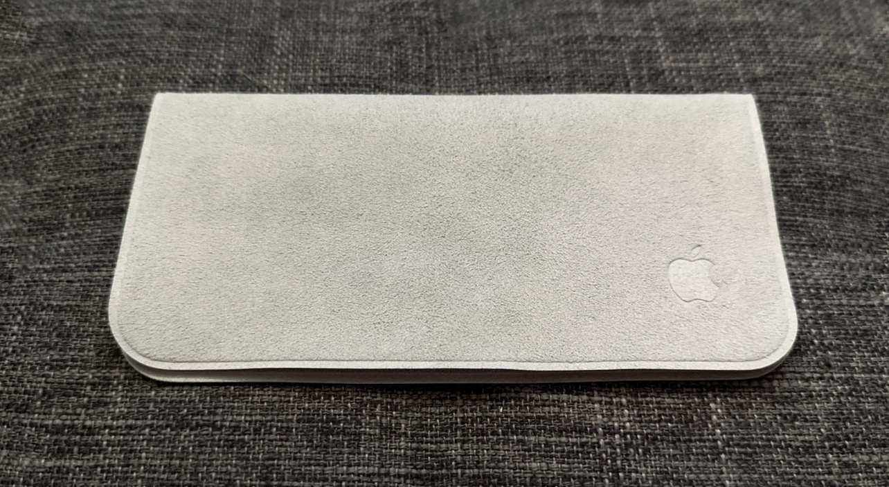

Apple Polishing Cloth will do its magic.

Just placed my order for one of these (I was hoping they would come in stock at my local Apple Store, but after 1 week, no such luck).
For now, OP, I use the glasses cleaning cloth that came with my Tom Ford eyeglasses. Seems to work fine. Just shake it out so there's not any tiny particles that can cause scratches on the screen.
I will also say, thankfully these laptop screens do not have Apple's ceramic shield technology--which makes the glass more crack resistant, but more prone to scratches.

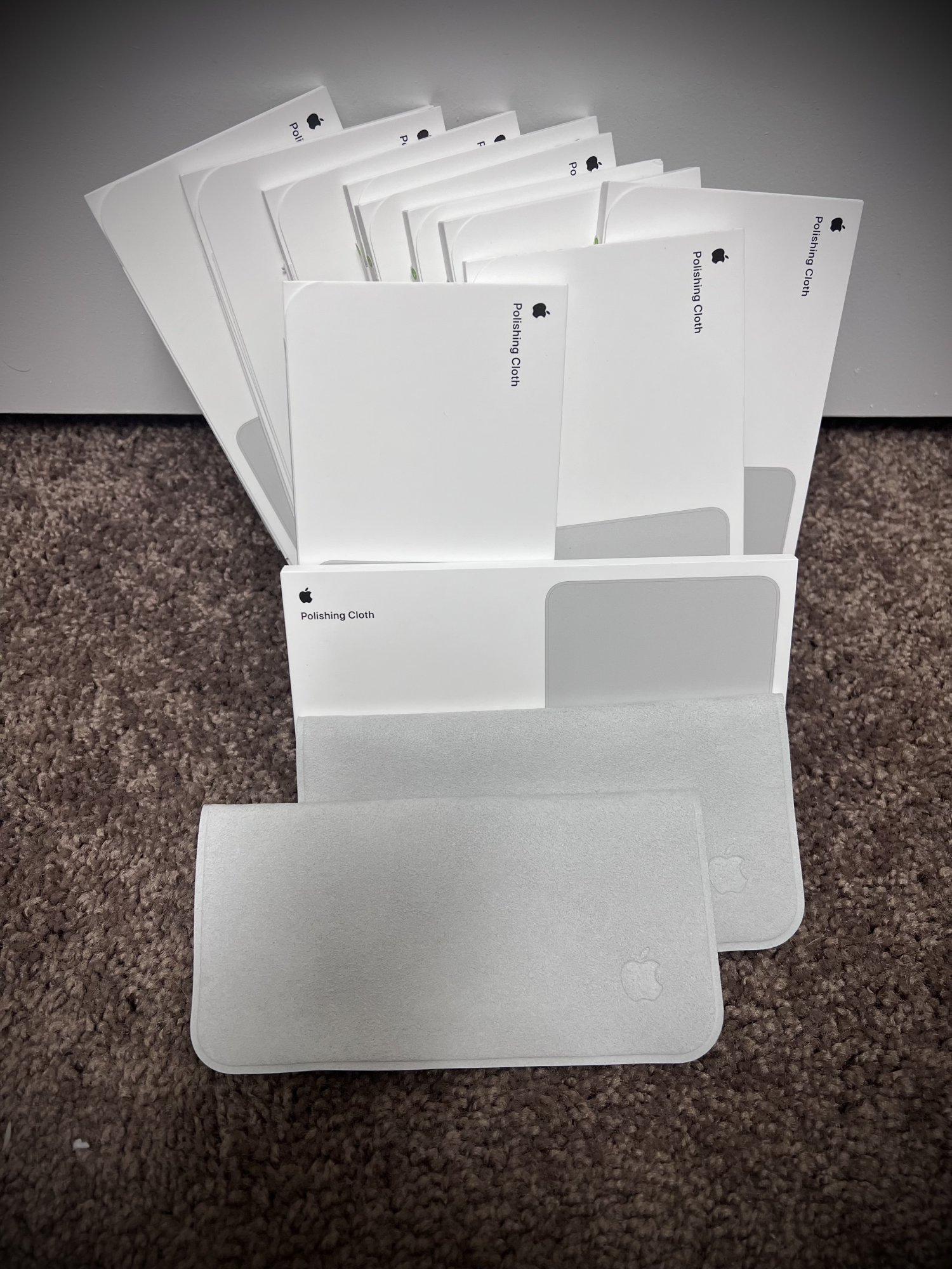

I wish I could give you one of mine. 😵‍💫
