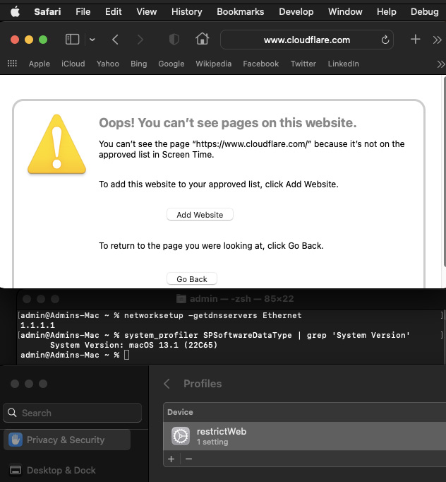

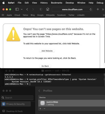

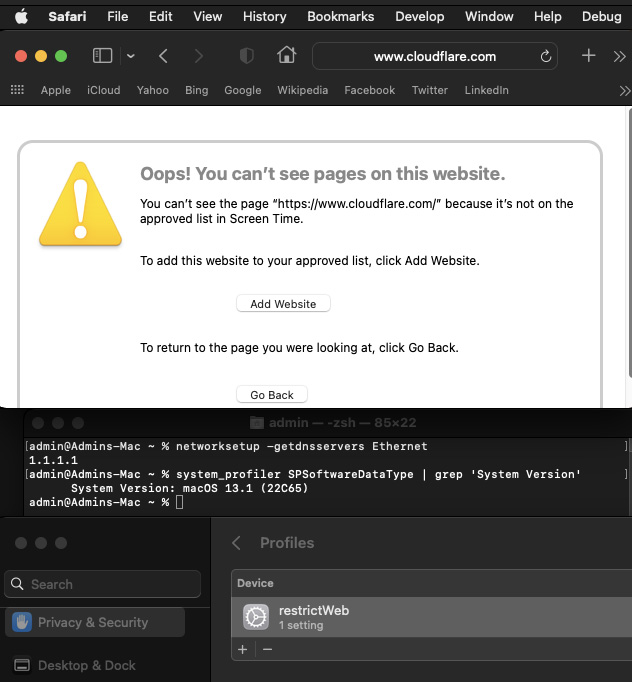

The website mentioned in the first post seems to be down, I used cloudflare.com as an example.
https://developer.apple.com/documentation/devicemanagement/parentalcontrolscontentfilter
