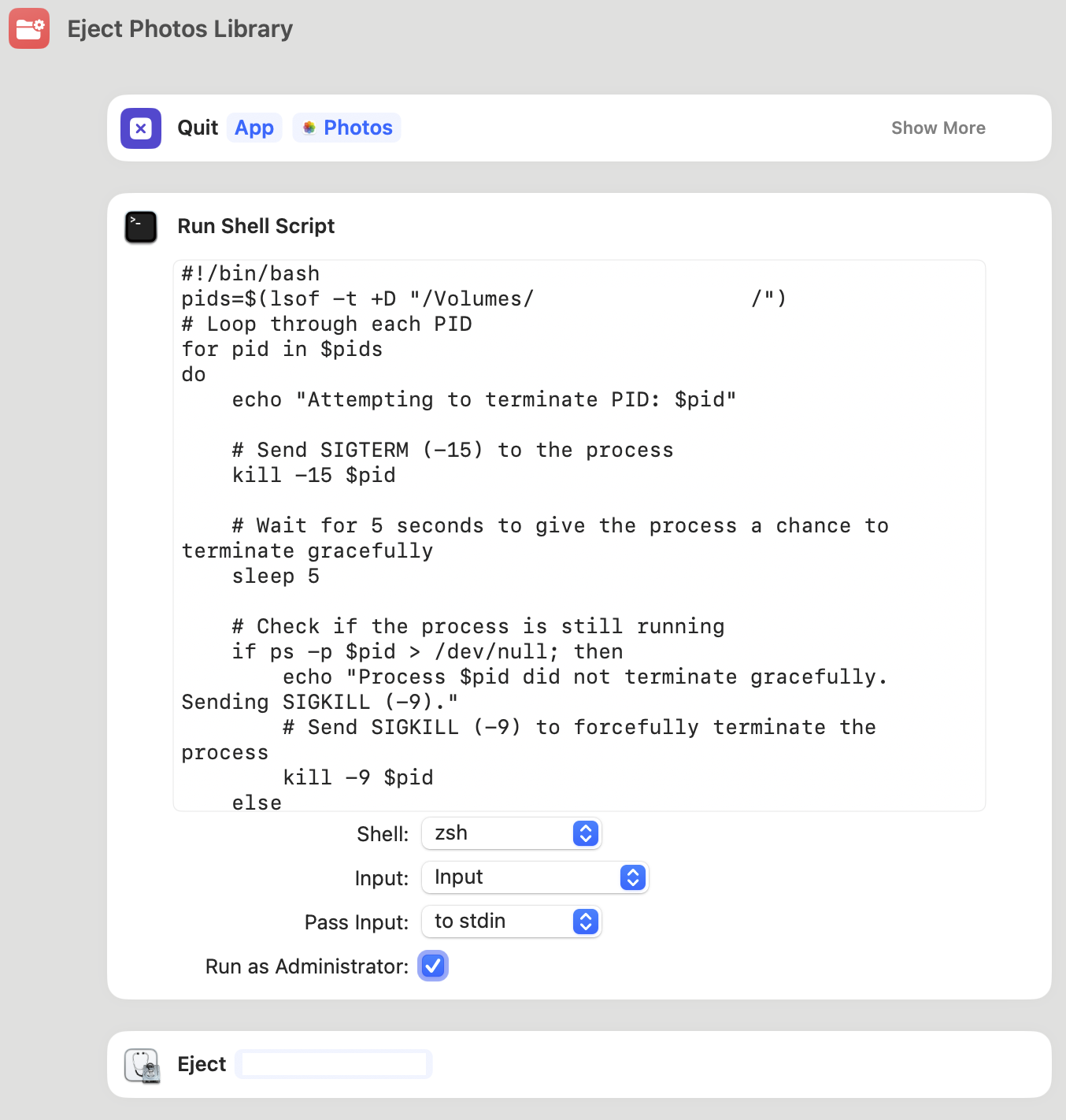

I created a Shortcut that:
1. Quits Photos
2. Uses a bash script to find all the processes using my external drive. It tries to quit them gracefully and then force quits them if they ignore the request.
3. Ejects the disk
It seems to work pretty consistently, if a bit slowly. If you wanted to speed it up you could update the bash script to force quit immediately, but I like giving it time to exit gracefully if it can. Make sure you run the script as an administrator.

Here's my Shortcut:
You can use the Shortcuts app to add it to the Dock or to the menu bar, if you'd like.
1. Quits Photos
3. Ejects the disk
Thanks for sharing your script and solution with the Macrumors audience as that may be useful for others in similiar situation.
Just note however that I don't think what you are doing is much different than the builtin Force Eject. Force Eject may not give the processes quite the grace period you do but otherwise I believe it also tries to kill all the processes using a volume/filesystem before unmounting it.

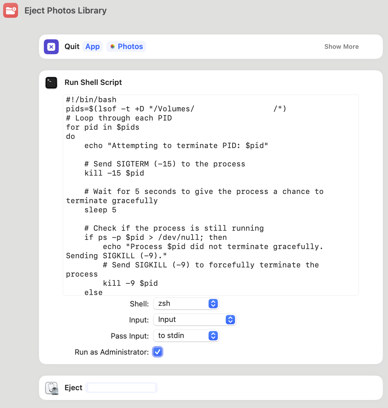

1. Quits Photos
3. Ejects the disk

Here's my Shortcut:
I think you can improve the elapsed time substantially with a bit of refactoring.
It's not necessary to wait 5 seconds per killed process. You can send all of them a kill -15, then wait a single 5-sec interval, then go thru all the pids again and send the kill -9 to any that remain. This changes the overall elapsed time from pid_count * 5 secs to essentially 5 secs, assuming it takes a negligible amount of time to issue each series of kills.
Here's my Shortcut:
Any particular reason for using the Eject action and not diskutil unmountDisk/diskutil eject?
