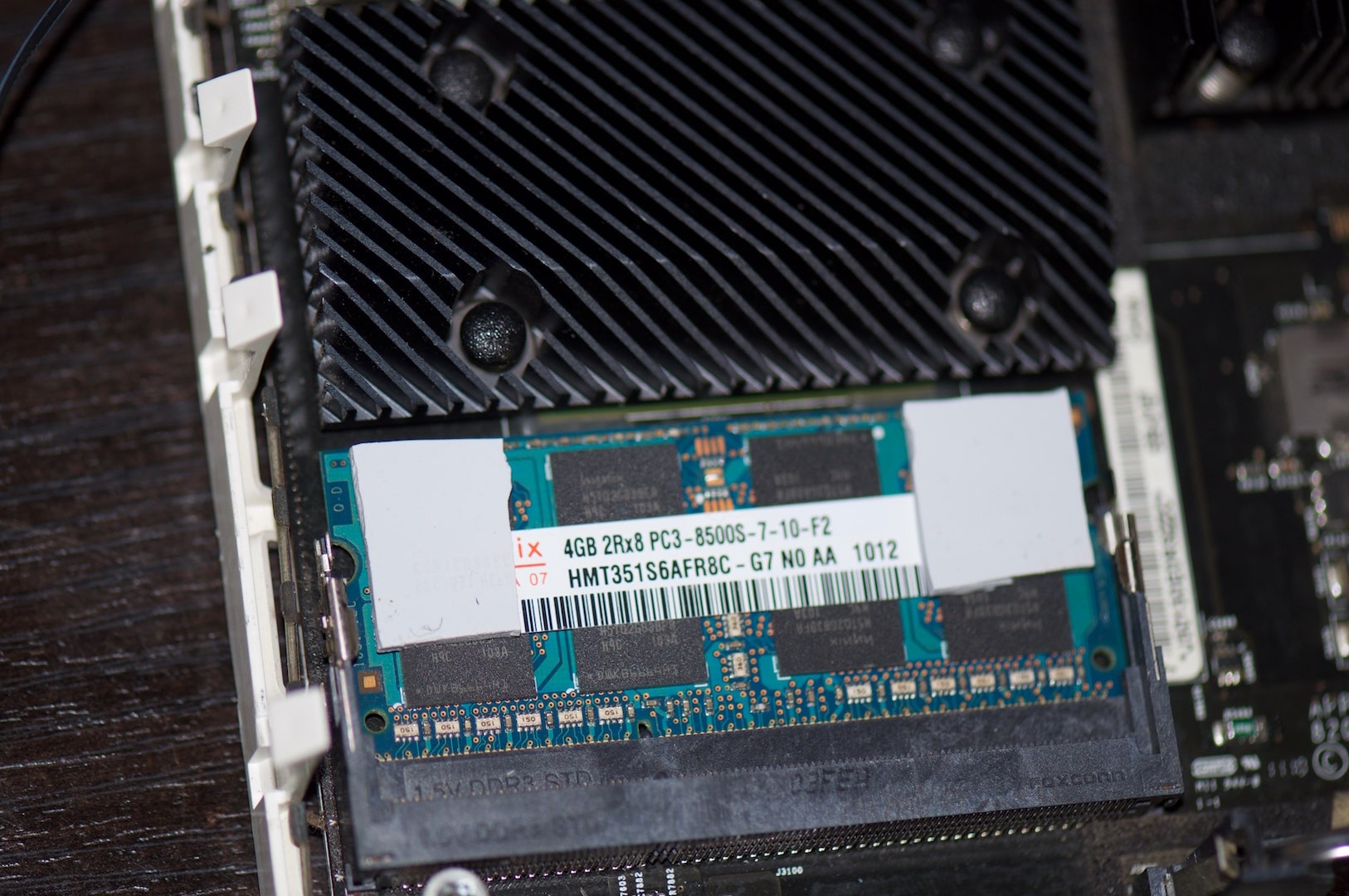

I did some research and came across some reports of people adding pressure to the modules (in later model minis), which could improve the module contacts. So, I tried padding the RAM out with a couple of off-cuts of 2mm thick thermal padding between the sticks of RAM, ensuring a snug fit when the top module is pushed into place. Sure enough, the mini fired up with a happy boot chime again.

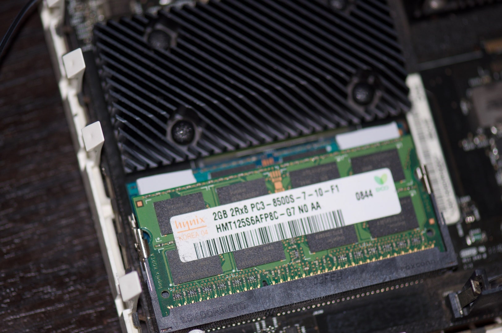

Any module in this lower bank (BANK0/DIMM0) resulted in 3 beeps, and no boot.

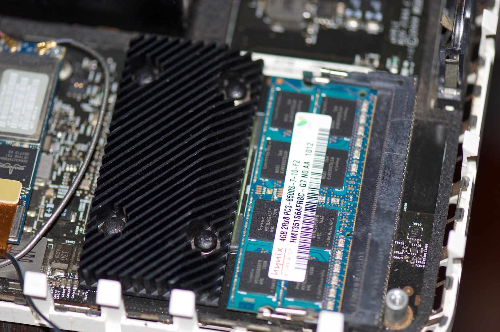

I added some 2mm thick thermal pads on top of the lower module.
With the pads, the top module now applies a little pressure to the lower slot once it clicks in.

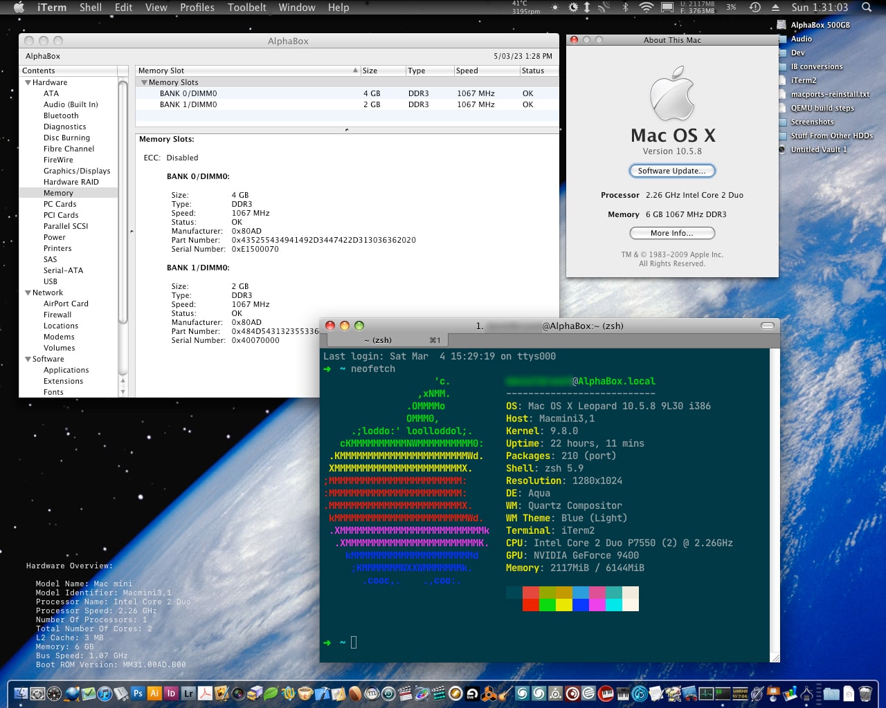

We now have a happy mini with plenty of RAM, tons of performance (for Leopard) and lots of software to enjoy.
