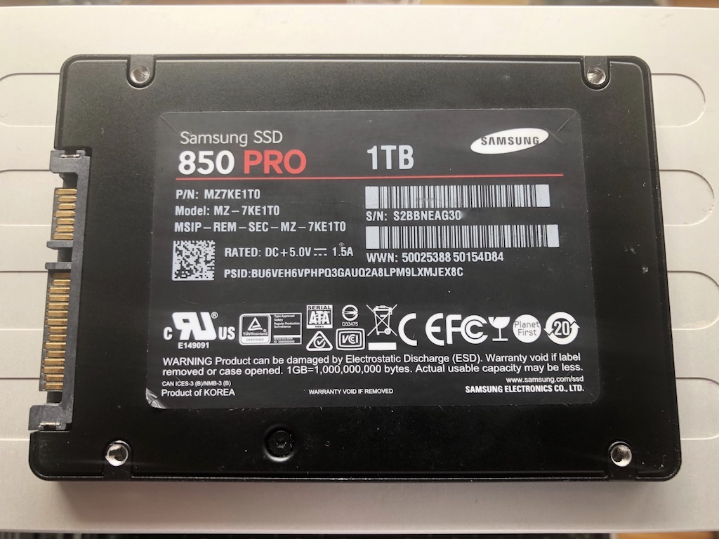

Having some trouble with a Samsung 850 Pro 1TB SATA SSD that decided to stop showing its OS X volume (grey circle with line) at turn-on and at the same instance started hanging terminally while trying to boot to Win 10.
P/N: MZ7KE1T0
Model: MZ-7KE1T0

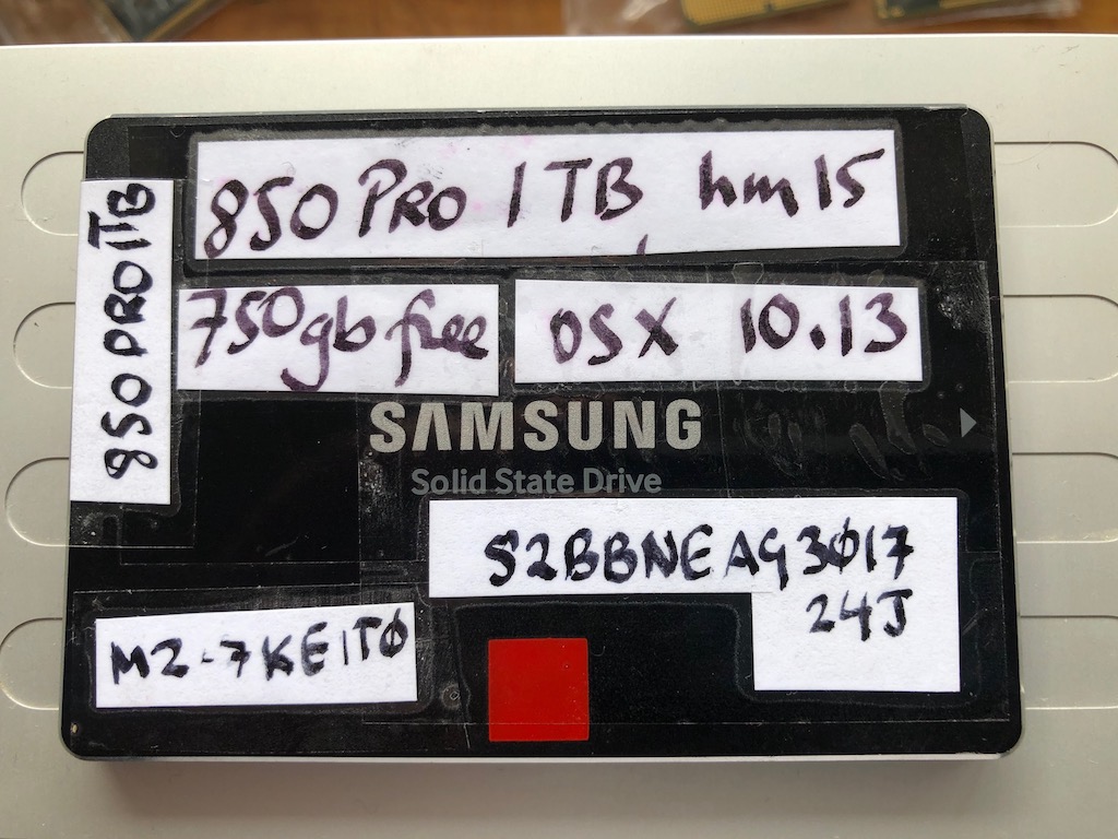

Heres the patient backside..
His front, write on them so I know what I have inside them...

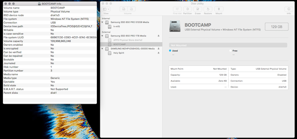

Disk Utility shows the disc, doesn't let me format, erase, restore to it...
The OS X Volume can't be mounted...
The WIN 10 volume can't be mounted...

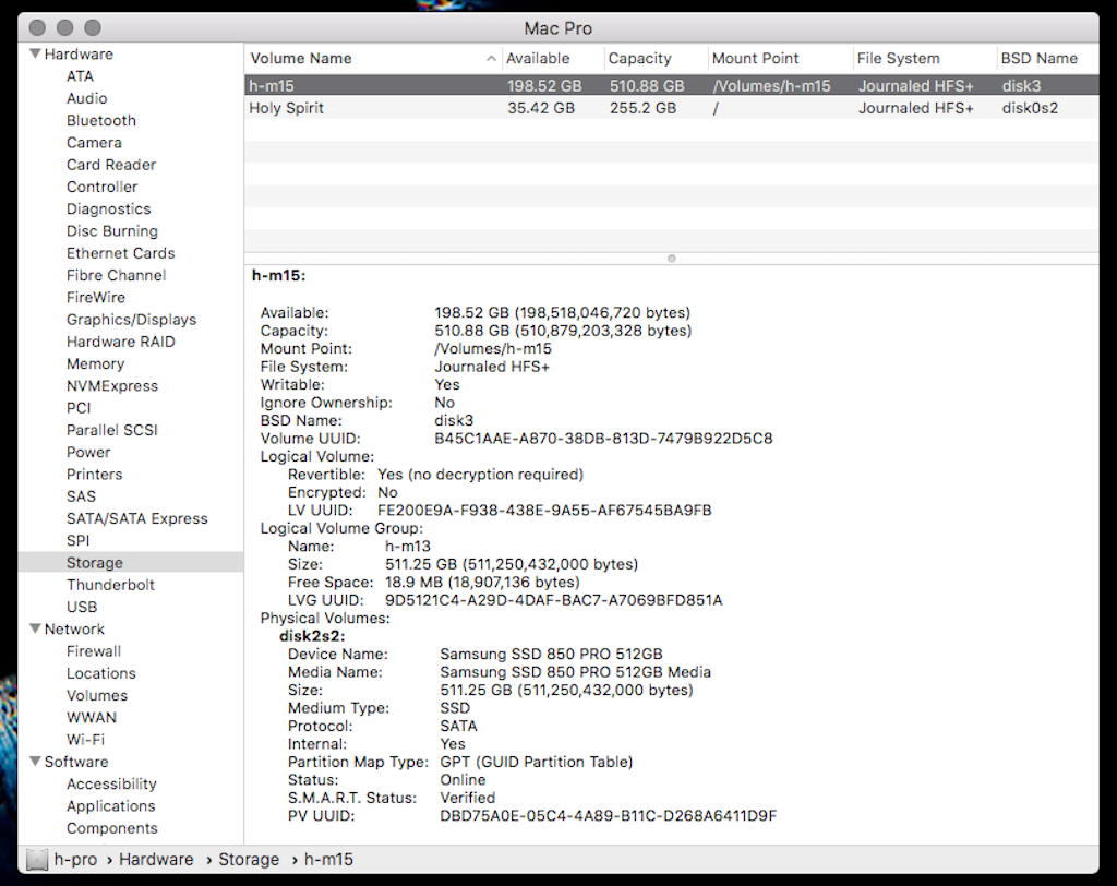

Disc doesn't appear in 'About this Mac' (here in Mac Pro)...
Disc doesn't appear in System Information in Mac Pro...

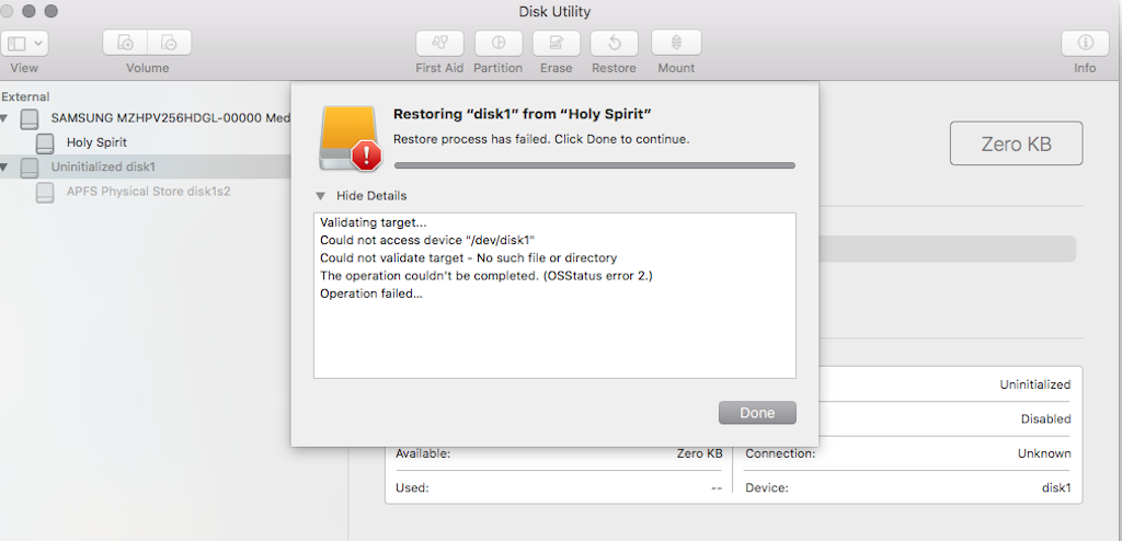

Can't restore another formatted disc to it...

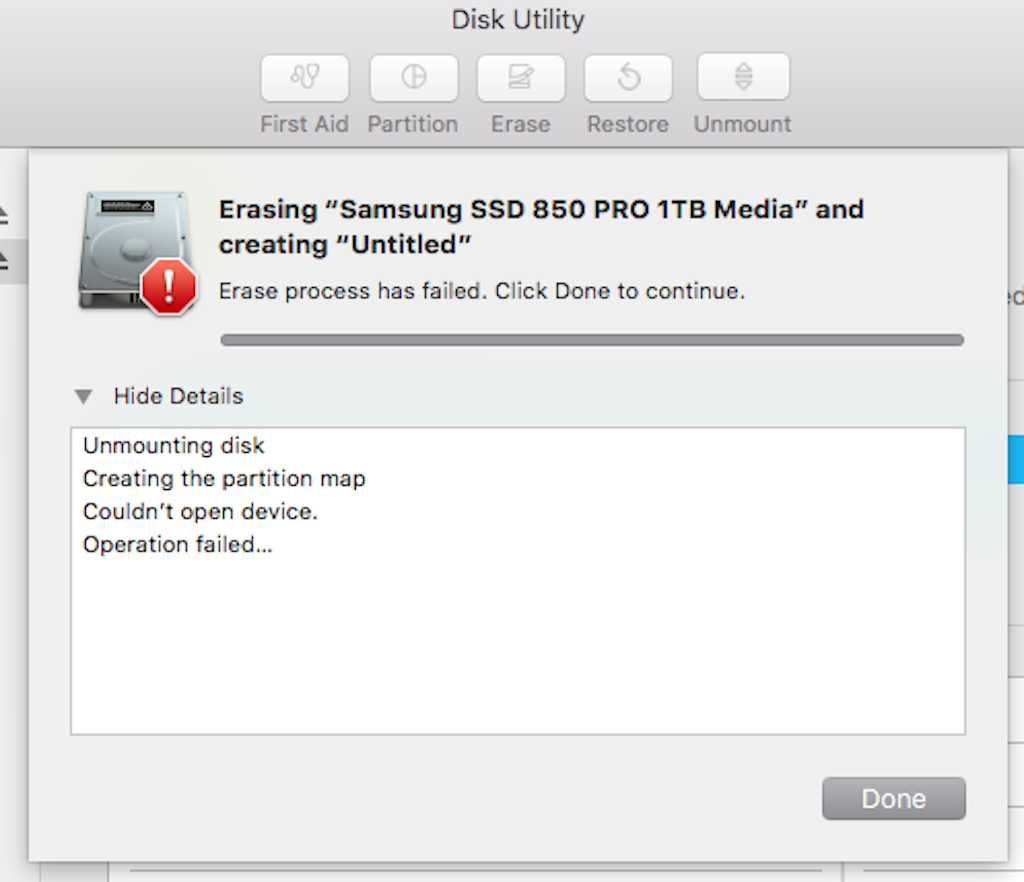

And can't erase it, have tried every combination in Disk Utilities from El Capitan ---> Catalina

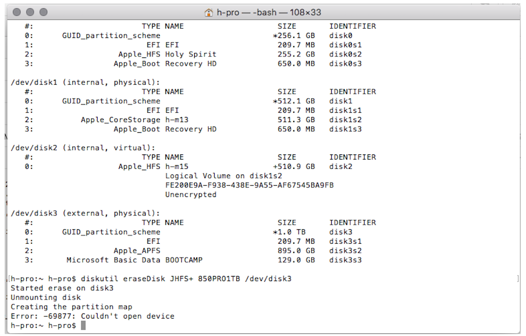

Using terminal to erase gives ‘Error: -69877: Couldn't open device'
i.e.
diskutil eraseDisk JHFS+ 850PRO1TB /dev/disk3

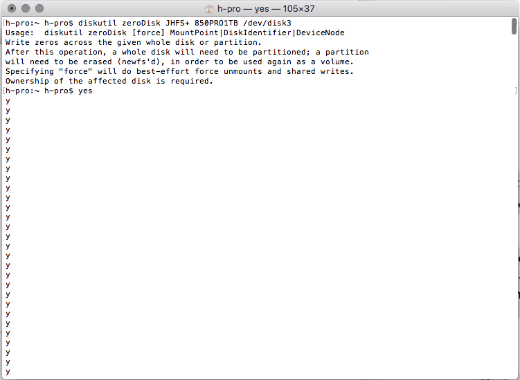

Using terminal to zeroDisk gives, and maybe I've done this command wrong, or didn't have proper disc privileges etc but it is writing thousands of 'y'... occasionally the light on the ORICO Dock flashes (where the SSD we're working on is sitting) but am unsure if anything useful is happening but just letting it run...
diskutil zeroDisk JHFS+ 850PRO1TB /dev/disk3

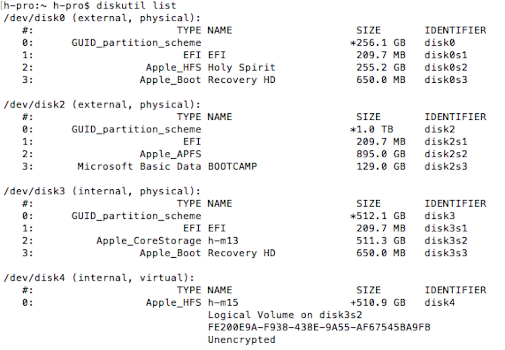

This is the detail of the disc and it's volumes provided by diskutil info:
h-pro:~ h-pro$ diskutil list disk3
/dev/disk3 (external, physical):
#: TYPE NAME SIZE IDENTIFIER
0: GUID_partition_scheme *1.0 TB disk3
1: EFI 209.7 MB disk3s1
2: Apple_APFS 895.0 GB disk3s2
3: Microsoft Basic Data BOOTCAMP 129.0 GB disk3s3
h-pro:~ h-pro$ diskutil info disk3
Device Identifier: disk3
Device Node: /dev/disk3
Whole: Yes
Part of Whole: disk3
Device / Media Name: SSD 850 PRO 1TB
Volume Name: Not applicable (no file system)
Mounted: Not applicable (no file system)
File System: None
Content (IOContent): GUID_partition_scheme
OS Can Be Installed: No
Media Type: Generic
Protocol: USB
SMART Status: Not Supported
Disk Size: 1.0 TB (1024209543168 Bytes) (exactly 2000409264 512-Byte-Units)
Device Block Size: 512 Bytes
Read-Only Media: No
Read-Only Volume: Not applicable (no file system)
Device Location: External
Removable Media: Fixed
Virtual: No
(disk3s2 is the 895GB OS X Volume)
h-pro:~ h-pro$ diskutil info disk3s2
Device Identifier: disk3s2
Device Node: /dev/disk3s2
Whole: No
File System: None
Partition Type: Apple_APFS
Media Type: Generic
Protocol: USB
Disk / Partition UUID: 67ABCDD6-4F0E-47EC-9715-0E04E4806CA1
Partition Offset: 209735680 Bytes (409640 512-Byte-Device-Blocks)
Disk Size: 895.0 GB (894999986176 Bytes) (exactly 1748046848 512-Byte-Units)
Read-Only Media: No
(disk3s3 is the 129GB WIN 10 volume)
h-pro:~ h-pro$ diskutil info disk3s3
Device Identifier: disk3s3
Device Node: /dev/disk3s3
Whole: No
Volume Name: BOOTCAMP
Mounted: No
Partition Type: Microsoft Basic Data
File System Personality: NTFS
Type (Bundle): ntfs
Name (User Visible): Windows NT File System (NTFS)
Media Type: Generic
Protocol: USB
Volume UUID: 68967E30-E09D-4C01-B7AE-6E36556EAFD1
Disk / Partition UUID: C59B61CA-B0BA-435F-AEA6-C47800DC65D6
Partition Offset: 895210225664 Bytes (1748457472 512-Byte-Device-Blocks)
Disk Size: 129.0 GB (128998965248 Bytes) (exactly 251951104 512-Byte-Units)
Volume Total Space: 0 B (0 Bytes) (exactly 0 512-Byte-Units)
Volume Free Space: 0 B (0 Bytes) (exactly 0 512-Byte-Units)
Read-Only Media: No
Read-Only Volume: Not applicable (not mounted)
And tried partitioning it, got the ‘Error: -69877: Couldn't open device' again:
h-pro:~ h-pro$ diskutil partitionDisk /dev/disk3 GPT JHFS+ New 0b
Started partitioning on disk3
Unmounting disk
Creating the partition map
(Is a disk in use by a storage system such as AppleRAID, CoreStorage, or APFS?)
h-pro:~ h-pro$

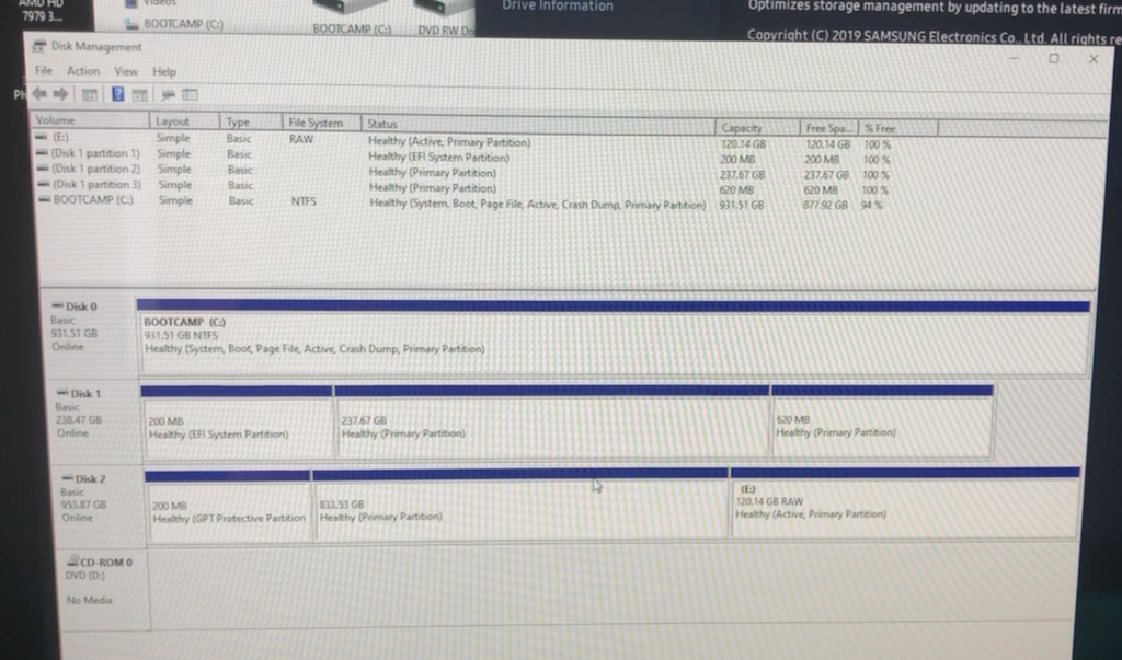

Booted into Windows 10, the disk will show up for a few (like 2-3) seconds then it disappears again, repeatedly this process cycles every 20 seconds or so, it is not showing up long enough to do anything in Disk Management.
It pops up as Disc 2 / Volume E with its Windows 10 120GB Healthy Active Primary Partition showing along with the 200MB Mac EFI and an ~850GB OS X partitions.
