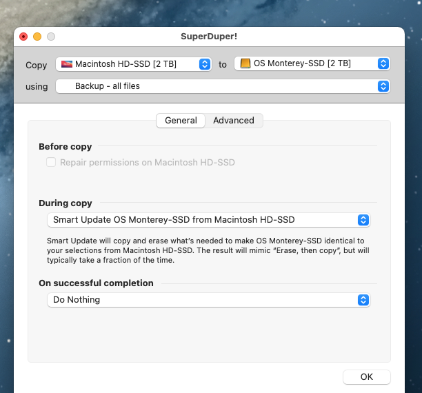

EDIT: I attach a screenshot of a Super Duper setting that looks like it might work. Not sure....
I would be careful with that 'Backup - all files' SuperDuper! script since I believe it's going to copy everything including the macOS installation since the what's it's going to do subtext states it will make the target identical to the source.
Hi. Thank you. Yes, that's exactly what I subsequently thought! That's a can of worms I don't care to open....

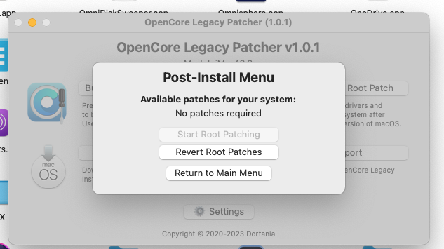

Hi again. Right, I just booted up into the Monterey SSD and reverted the root patches. Two things happened. I had to restart (of course) for it to kick in.
1. the boot up was a lot slower.
2. I lost both of my 23" Apple displays that I have connected to my iMac. No matter, I can get them back when I reactivate the root patcher.
So, Now it's kind of ready to try the Migration again, which I cannot do right now. Will let everyone interested know how that pans out. In the meantime, if anyone has further thoughts please let me know. Thank you all for your time.

I didn't receive such a prompt to Migrate. This is what I get, as default, with OCLP app. Attached, from the Big Sur SSD, but it's the same in Monterey.
I'm thinking that the OCLP stuff is interfering with migration assistant.
Perhaps it also interferes with SuperDuper and CarbonCopyCloner.
(I've never used OCLP, so I don't know enough about how it works).

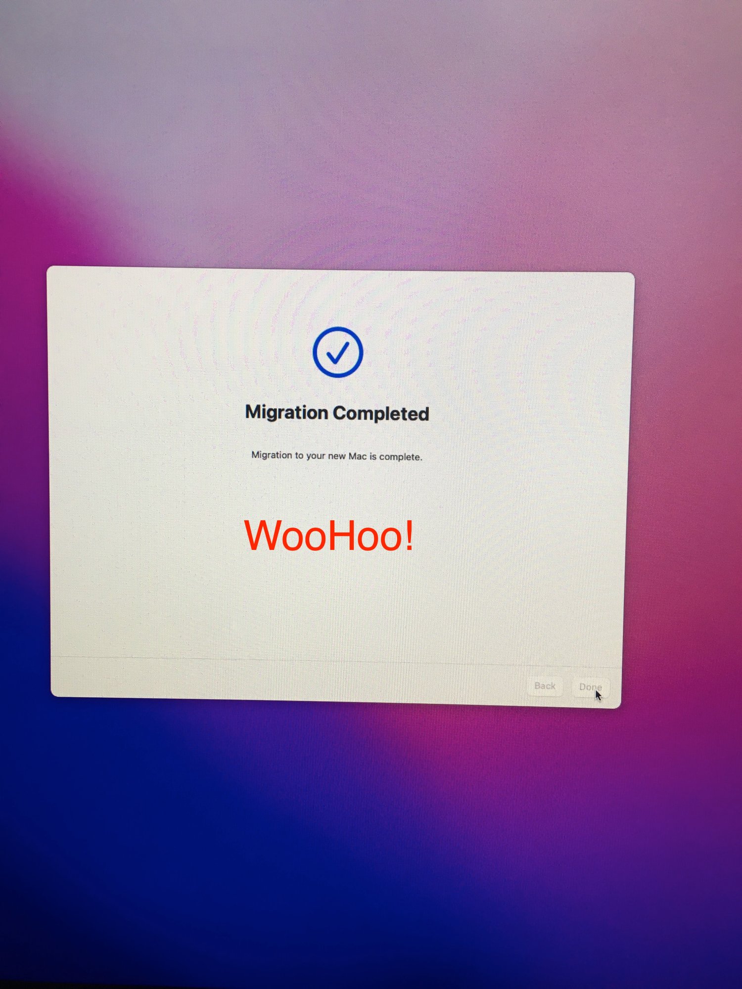

SUCCESS! Thank you so much, Sir, for your suggestion. It worked. The migration was 100% successful. BUT.....
Now Monterey will not boot up.I kid you not. This is becoming like a Rubik Cube. I get one side right and another side screws up. It's been an interesting day. The Migration Assistant worked, as per your advice. I'm very, very grateful. But now I'm back to this stuck boot up, which was happening previously to me. And others, I understand.
I'm not sure if this is the case, but it seems to be something to do with introducing Big Sur into the equation, because my "virgin" Monterey booted up fine, and pretty quickly. Dunno. It's beyond a dumbass like me, lol.
So, right now, I've had enough, and I feel this issue is veering off-topic, as I'm moving into a stuck boot issue. Going to need a break from this over the weekend, but it's a professional necessity that I get Monterey working. I intend to purchase a Mac Studio. As as a pro composer, using Macs, it's well-known that one steers clear of the latest OS's. So, I need a working external SSD version of Monterey, because I'm going nowhere near "Sonoma", or even Ventura, for some time to come.
Cannot understand why all this is so difficult with Monterey, when Big Sur was a delight to install. It boots up slowly, though, but it works.
Once again, thank you, reppresident, for your time and help. I feel I'm close. Very close.
