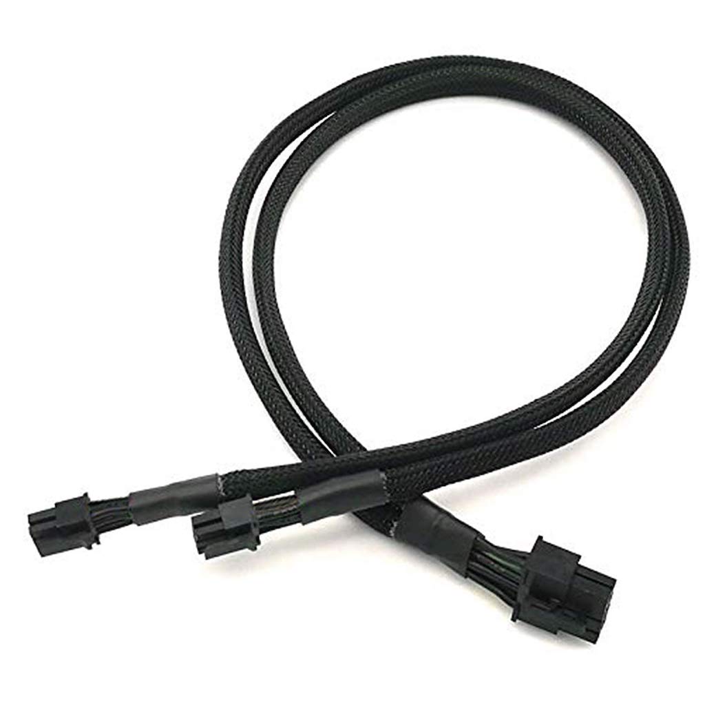

				The R9 280 X has two power sockets.
BOTH must be powered.
For the GPU 8 pin socket use
2 X Mini 6 pin to 1 x 8 pin
US$7.95 at Amazon
Dual Mini 6 Pin to 8 Pin PCI Express Video Card Power Adapter Cable
Features: Dual Mini 6 Pin to 8 Pin PCI-e cable is to connect a PCIe video graphics card with 8 pin port to Mac motherboard with mini 6 pin port; Specification: Cable Length: 15-inches/(38cm) ; Connector 1: standard GPU 8 Pin male ; Connector 2 : 2x mini 6 pin male ( not standard 6 pin male...www.amazon.com

A 8-pin PCIe connector signals to the GPU that it can draw up to 150W.You can directly use 2 power cable to the board:
1x 6 minipin to 8 pin
1x 6 minipin to 6 pin
But both power connector on the card must be powered.
Mac Pro mini-PCIe 6-pin is rated to 75W with the emergency power cut-out by the SMC at around 120W. So, you can't use just one mini-PCIe 6-pin to connect to a 8-pin PCIe GPU input.
While several people successfully draw more power from the mini-PCIe AUX connectors, it's not a god idea to use anything near to the power cut-out.
Around 90W, ok, while 110W+ is asking for a replacement backplane in the near future.
