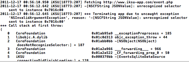

i read information in my database i use JSON but there is exception
'NSInvalidArgumentException', reason: '-[NSCFString JSONValue]: unrecognized selector sent to instance 0x6166970'
I think exception in this part

I try put NSLog to know which line is exception
when put NSlog before this line
Code:
	NSArray *array = [str JSONValue];
it is printed
after it doesn't printed :(

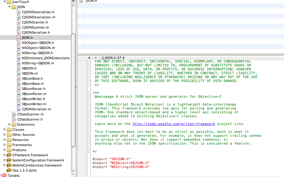

So there is a category on NSObject. A are you including the .m as well as .h in your application? If not there is no compiled version of the category at runtime which would give exceptions like you are seeing.
I see the declaration in "NSObject+SBJson.h"
Make sure you have "SBJson.h" imported.
Also that all the library source files copied into your project.
ya i copy all file JSON
i try print str after
Code:
	NSString *str = [[[NSString alloc] initWithData:buffer encoding:NSUTF8StringEncoding] autorelease];
	NSLog(str);
print all contain in str
after that is crash !!!!
The runtime error indicates you may not have. Can you post a screenshot of your Project setup showing the .m files, specifically them getting compiled into your application executable?

None of that is what I have asked for: are the .m files that form the actual implementation of the various headers included by JSON.h actually in your project. You are seeing an error that indicates they are not. You are including the headers so the NSObject category is available at compile time. But the error is very clear: it's not available at run time. So the most likely outcome is you have not included the .m files in the project. Once again: please provide a screenshot showing that you have included the .m files in your project and that they are being compiled into the final executable.

I solve exception by change location files class of JSON but the event doesn't
