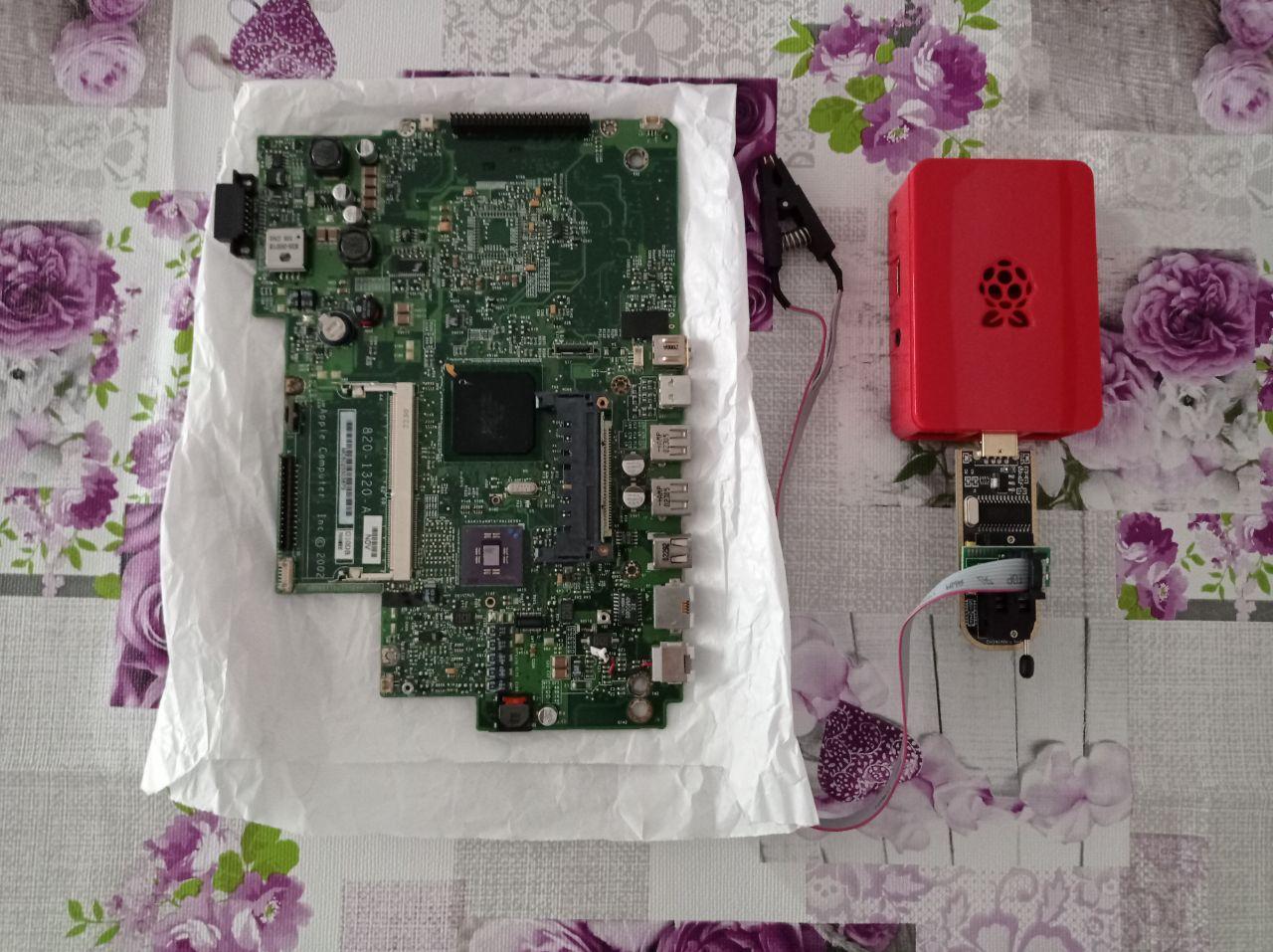

So I have a spare iBook G3 logic board, and what I want to do is read the contents of the Open Firmware ROM with an EEPROM flasher. But I have been trying for a while to guess which one of the dozen or so EEPROM chips is the one that actually contains the Open Firmware ROM.
Does anyone have an idea of which chip is it?
it will be a relatively large (compared to a normal EEPROM) 40 pin TSOP chip in a rectangular package its a parallel flash chip not a SPI one so your going to need a different hardware flasher sadly
