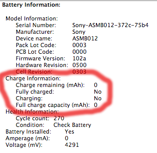

Have a look at System Profiler > Hardware > Power and look what it says under Full Charge Capacity.
Under full charge capacity, it says "6991 mAh."
I am not sure if that is good or bad. However, I still do not understand how in the world my battery would be at 80% with a few hours remaining and then all of a sudden go into sleep mode and have 0% of a charge left.

Is the battery an Apple battery or do you think it's a third party battery?
Because the original and full capacity of Apple's iBook batteries is 4800mAh.
And sometimes batteries give false information about their original capacity, like my iBook, it says I have 12000mAh, others have reported to have 20000mAh.
