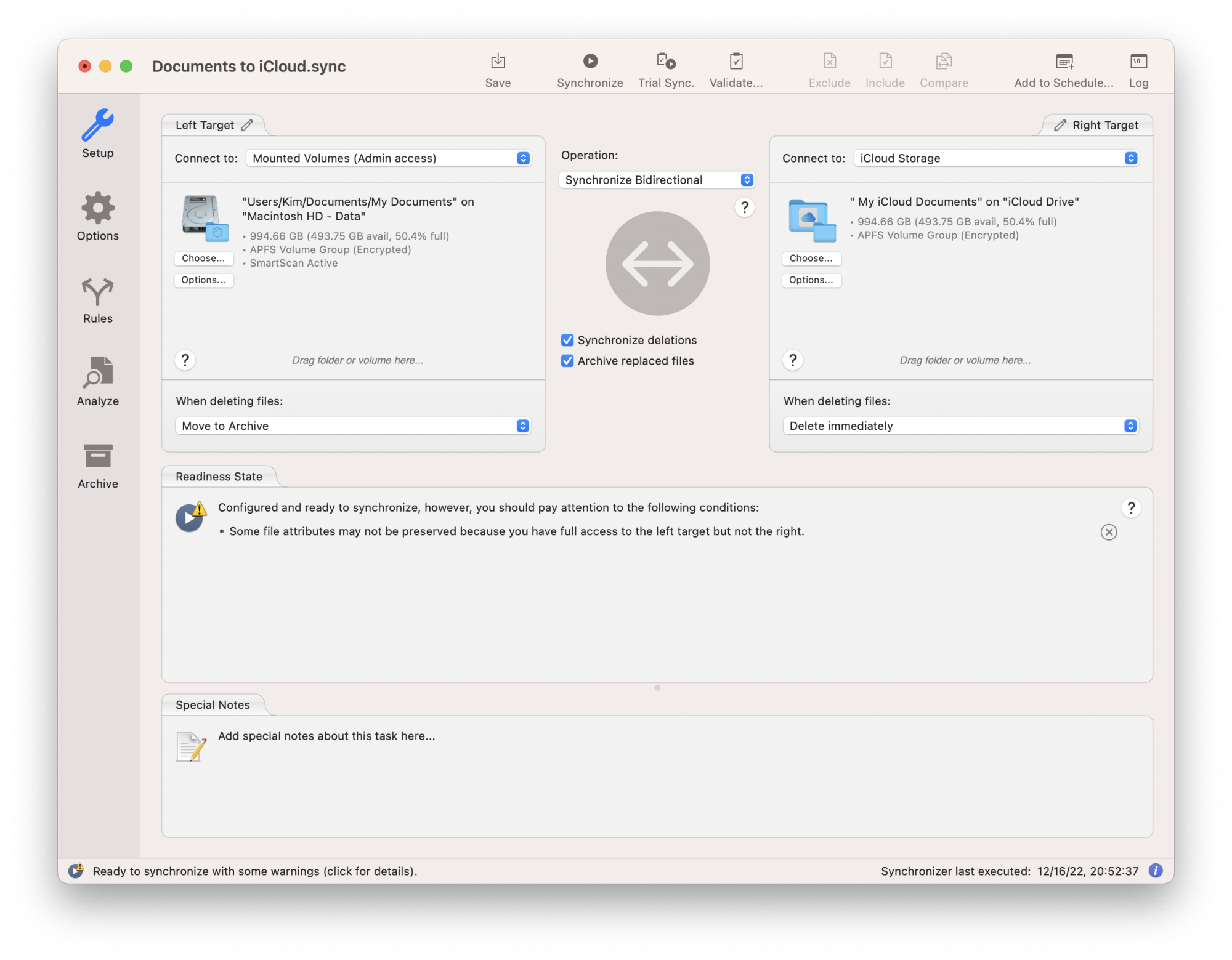

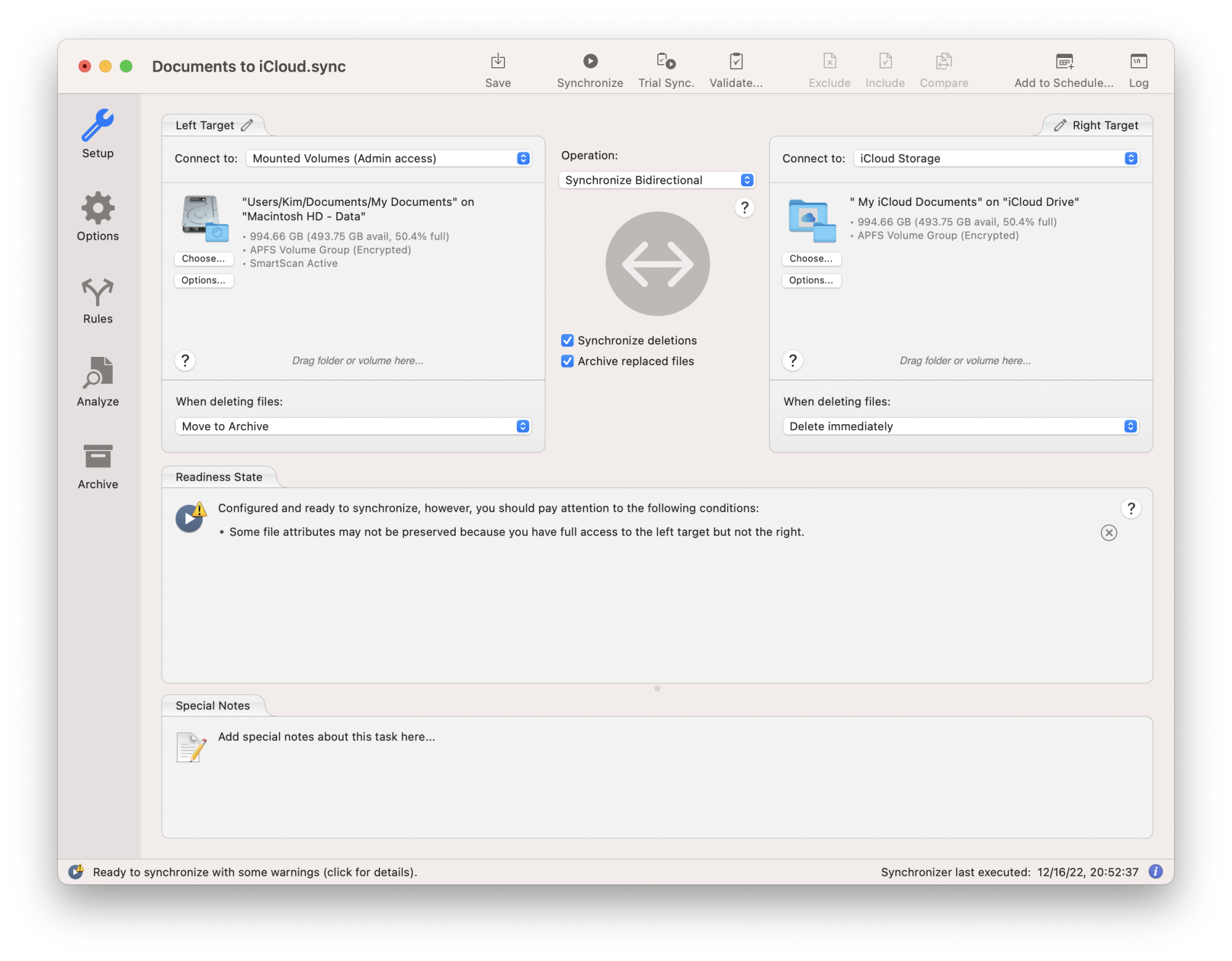

My solution is to use Chronosync to sync a copy of my documents to iCloud Drive​
Instead of moving all my documents into iCloud Drive, I am continuing to keep them in my macOS Documents folder.
But in addition to that, I also set up a bidrectional sync, using Chronosync, between my Documents folder and a folder in iCloud Drive.
Chronosync is able to properly handle evicted files in iCloud Drive.
And the really cool thing is that you can set up Chronosync to never fully delete or replace files in your local documents folder. Instead it puts deleted and replaced versions into an "Archive folder".
This has two benefits:
  1. It protects you from data loss, because you can always restore a deleted file or the replaced version
  2. It gives you visibility when something was deleted or modified on the iCloud side
So...
  • When I delete or replace a file in my local Documents folder, then it is also replaced and delete immediately in iCloud Drive
  • But when I delete or replace a file inside the iCloud Drive (whether it's on my Mac, an iPhone or any other device), then the file is moved into the archive on my Mac instead of being deleted or replaced

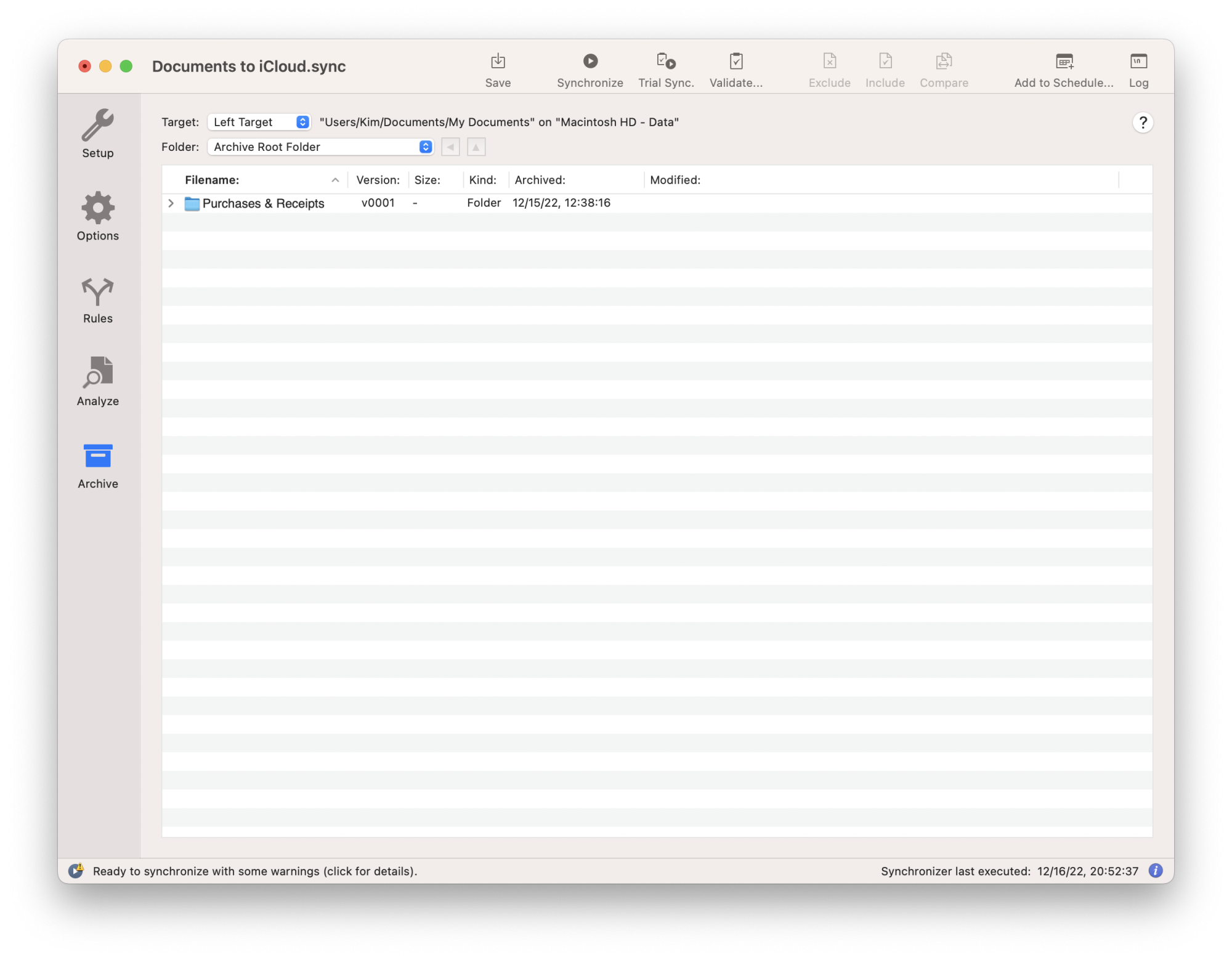

Here is what the archive like after I deleted a file from my iPhone:
I was able to restore it with just a few clicks to my Documents folder and a few seconds later it was synced back again to iCloud Drive.

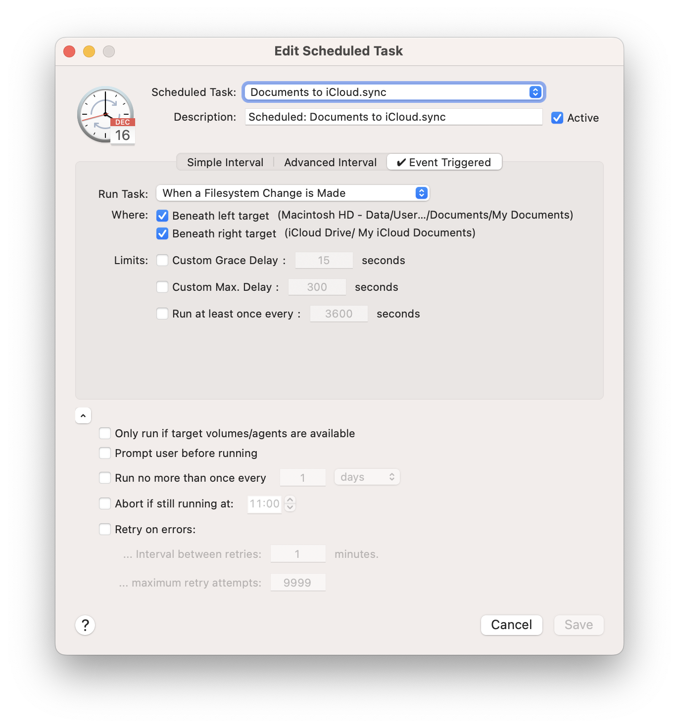

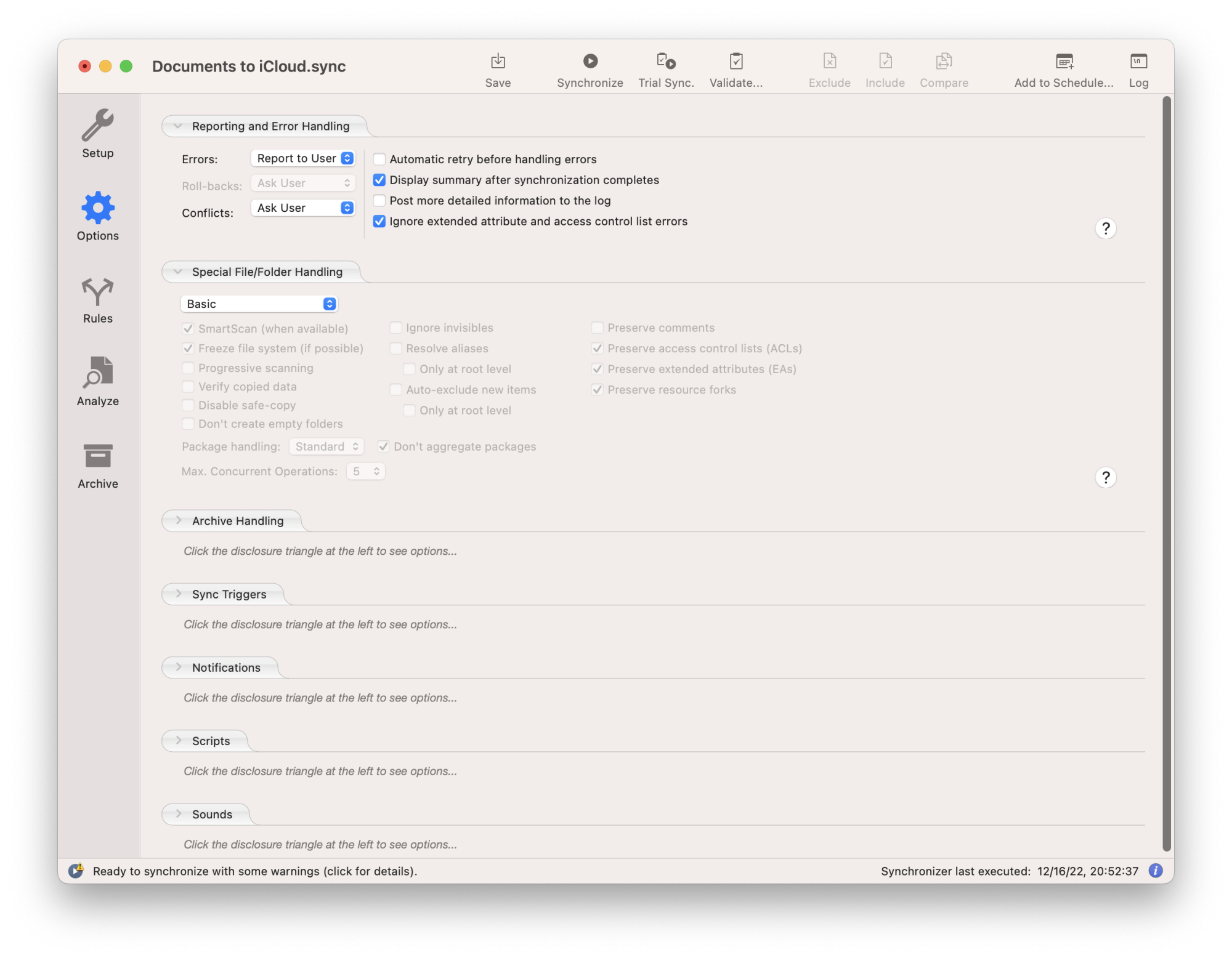

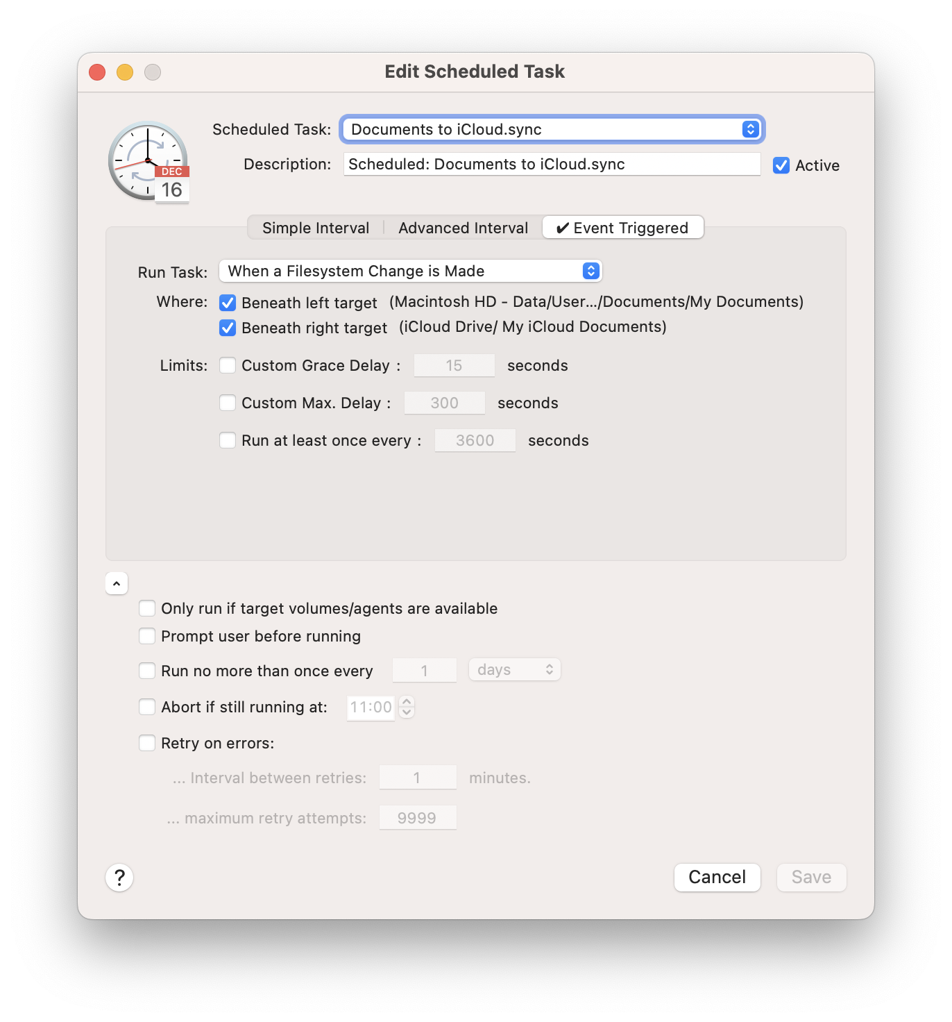

I have had this running for a few days now and so far it's been working well. Chronosync even has a function to validate if all the files are properly in sync.
And you can enable "Smart Sync" functions that schedule the sync only when files are actually changed in the documents folder or on iCloud.

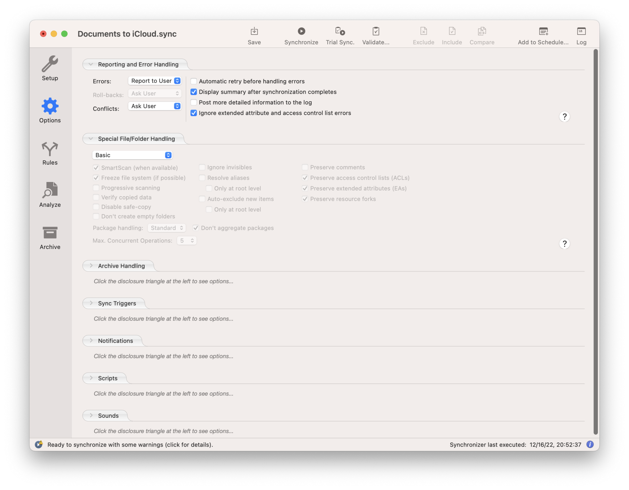

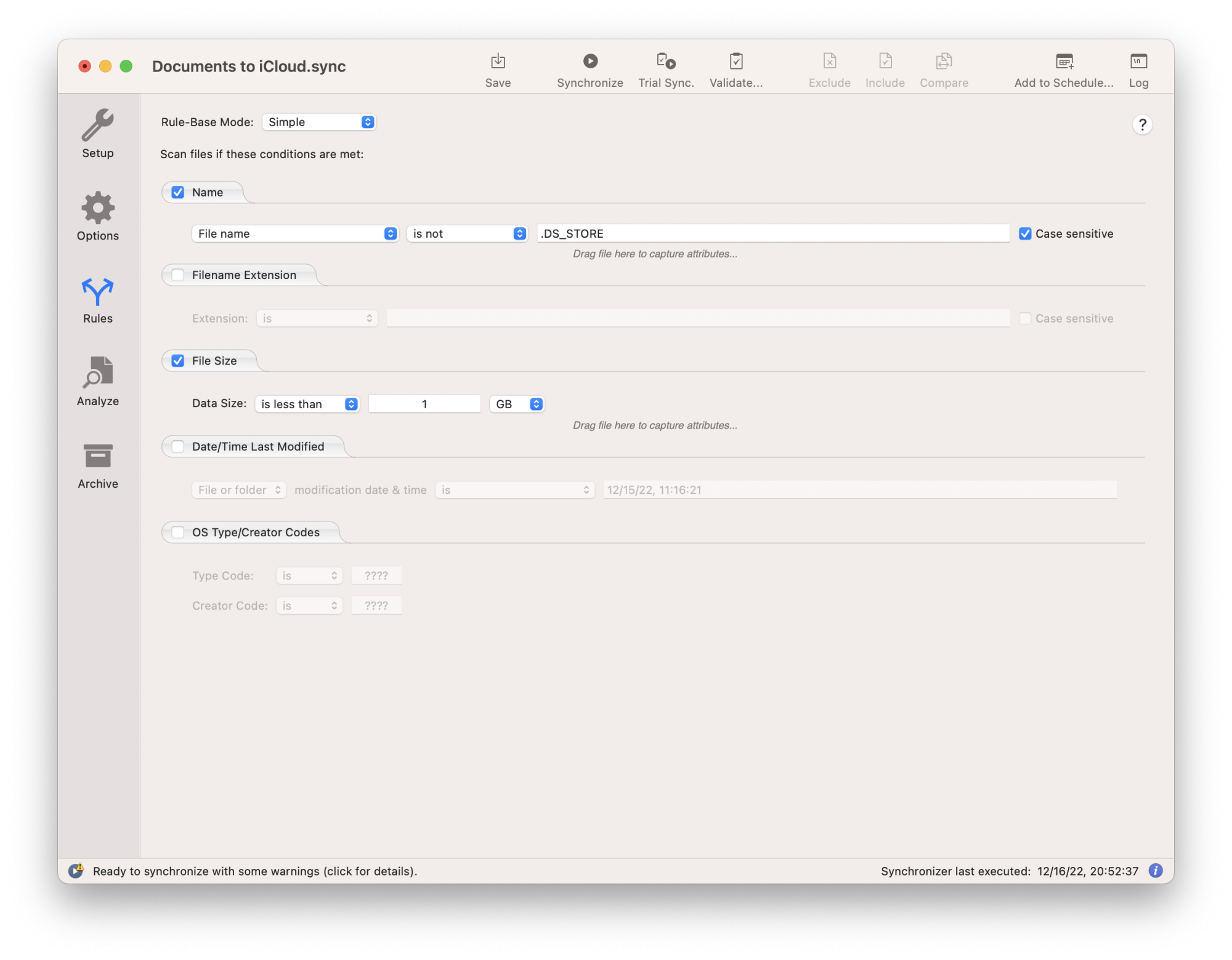

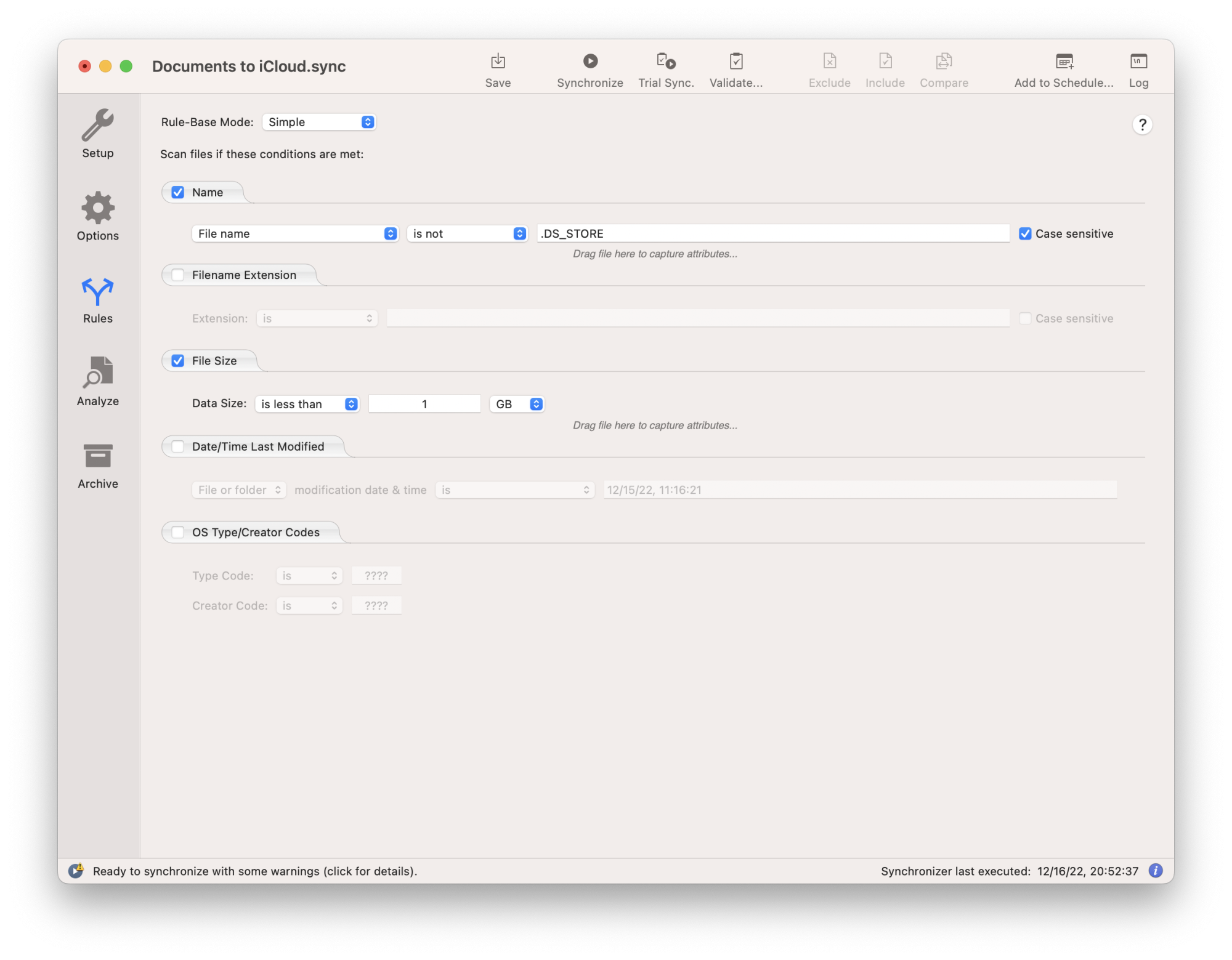

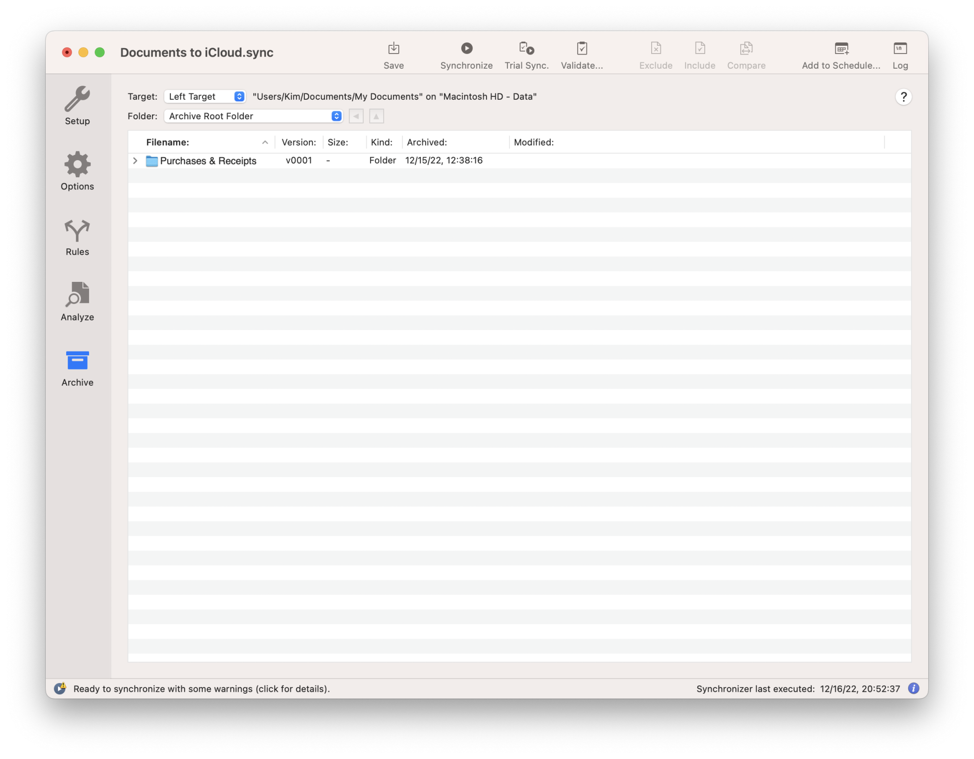

Here are my settings:
