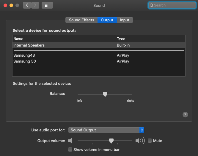

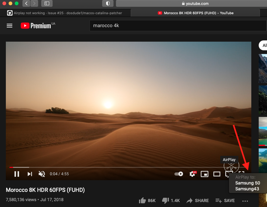

Symptoms: no AirPlay logo on status bar, no AirPlay Display drop-down menu in Display Preferences, but AirPlay devices are listed in Sound Preferences as possible options for sound output:
![Screen Shot 2021-03-14 at 10 21 42 PM Screen Shot 2021-03-14 at 10 21 42 PM]()
When playing a YouTube video in Safari, AirPlay mirroring option appears and actually WORKS:
![Screen Shot 2021-03-14 at 10 23 21 PM Screen Shot 2021-03-14 at 10 23 21 PM]()

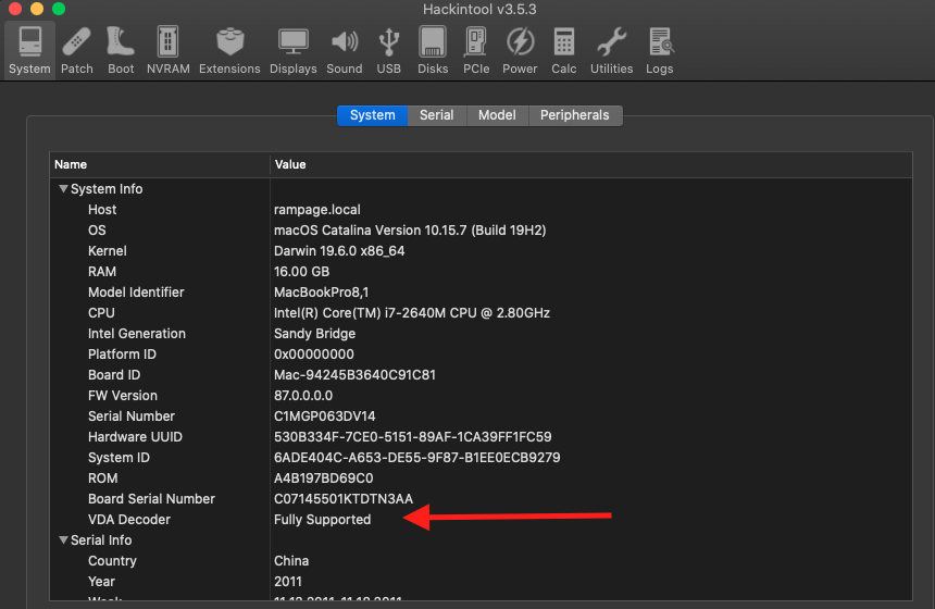

After investing a lot of time to research the possible reason, I finally found a solution.

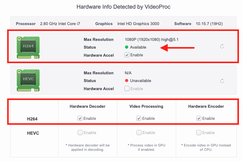

The reason why this happening is actually because AirPlay mirroring requires hardware acceleration to be correctly detected by operating system.
It happens that after clean Catalina install using macos-catalina-patcher, though Intel HD3000 hardware acceleration works perfectly, VDA H.264 hardware decoding/encoding is not working (or at least it is not correctly identified by operating system).
To check this, you can use tools like VDADecoderCheck, VideoProc's Hardware Info, but I would suggest latest release of Hackintool - https://github.com/headkaze/Hackintool/releases/tag/3.5.3
Hackintool will report that "VDA Decoder failed", "Hardware acceleration is not available", same as VDADecoderCheck. VideoProc will also report that both H264 and HEVC hardware decoder/encoder and video processing acceleration are not available.
To fix the problem, you can download and install latest release versions of two well-known kexts: Lilu.kext and WhateverGreen.kext - just put them to /Library/Extensions and follow regular kext install procedure.

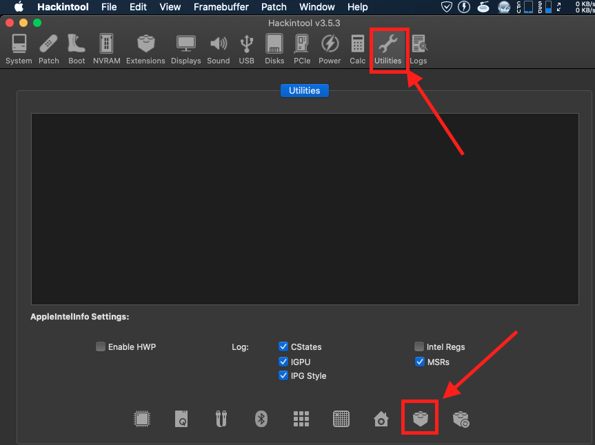

For those who could find this post using Google: if you are unfamiliar with installing kexts manually, fixing kext permissions, rebuilding kext caches etc. and just need simple instructions to make it work, here they are:
![Screen Shot 2021-03-14 at 10 47 48 PM Screen Shot 2021-03-14 at 10 47 48 PM]()
![Screen Shot 2021-03-14 at 10 51 54 PM Screen Shot 2021-03-14 at 10 51 54 PM]()
![Screen Shot 2021-03-14 at 10 54 38 PM Screen Shot 2021-03-14 at 10 54 38 PM]()
![Screen Shot 2021-03-14 at 10 58 19 PM Screen Shot 2021-03-14 at 10 58 19 PM]()
![Screen Shot 2021-03-14 at 11 05 07 PM Screen Shot 2021-03-14 at 11 05 07 PM]()
![Screen Shot 2021-03-14 at 11 07 39 PM Screen Shot 2021-03-14 at 11 07 39 PM]()

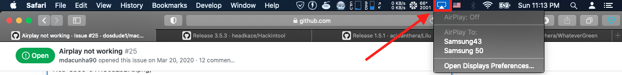

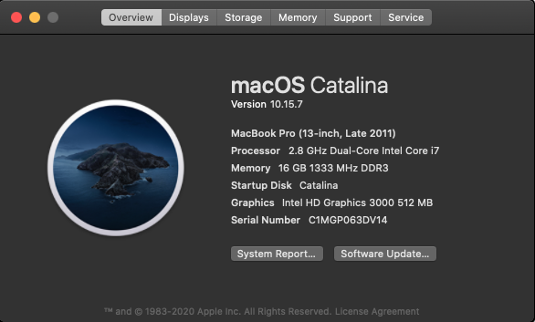

And finally what we were fighting for:
![Screen Shot 2021-03-14 at 11 13 42 PM Screen Shot 2021-03-14 at 11 13 42 PM]()

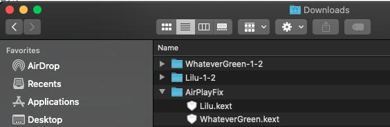

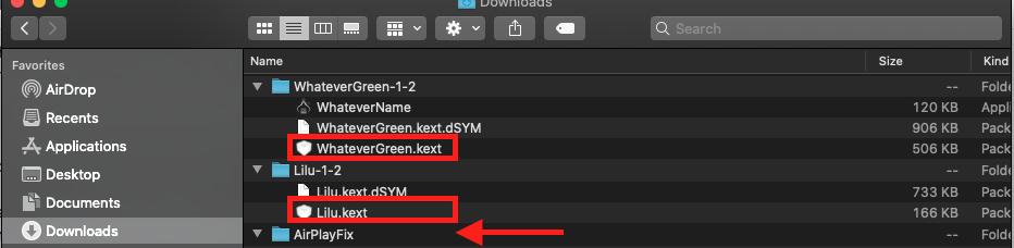

- Create a folder AirPlayFix in your Downloads folder.
- Download Lilu.kext
- Download WhateverGreen.kext
- unzip Lilu-1.5.1-RELEASE.zip and WhateverGreen-1.4.8-RELEASE.zip
- Copy or move Lilu.kext and WhateverGreen.kext from their respected unzipped folders to AirPlayFix folder:

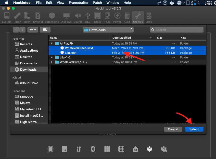

- Download, install and launch Hackintool, go to Utilities tab and use Install kext(s) button:
- Select Lilu.kext and WhateverGreen.kext:
- When prompted for destination, select /Library/Extensions, wait for the process to finish, then reboot.
(It's ok in my particular situation for HEVC to be unavailable since my CPU/GPU don't support HEVC acceleration)
