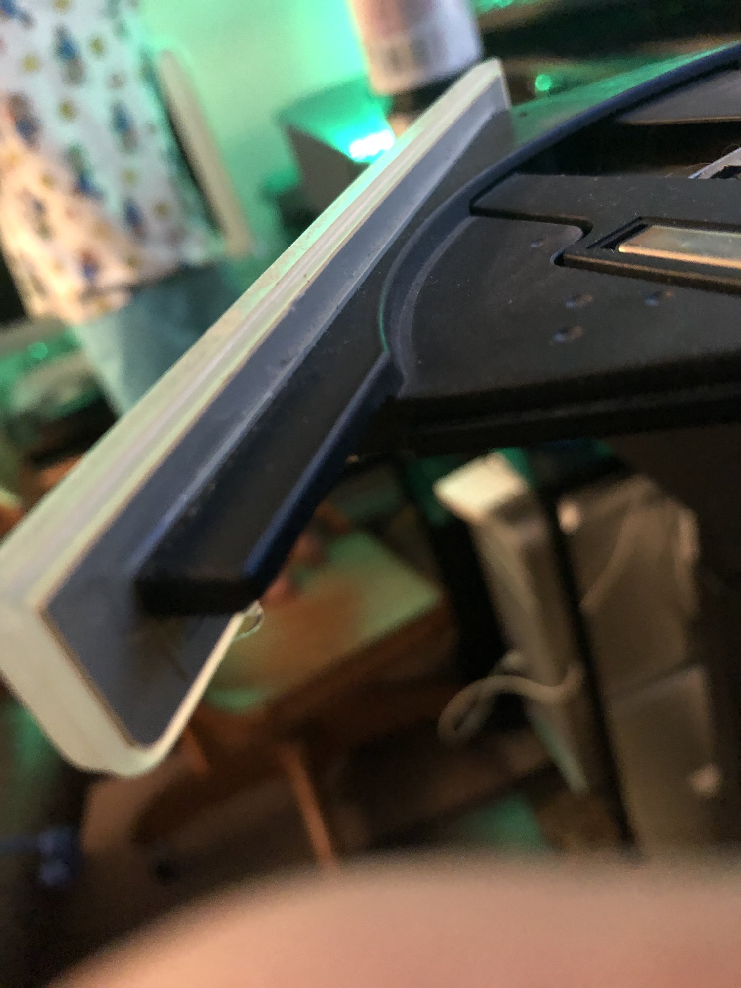

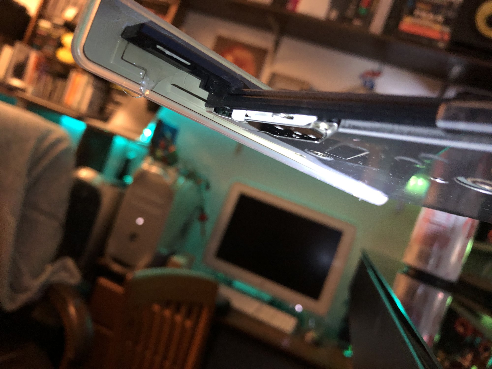

Did you glue the bezel onto the drive, or try glue the plastic tabs of the bezel back on? It was the plastic tabs that snapped on me.
Same, I glued the entire bezel onto the front of the tray. Worked well.
The connectors just disintegrated completely - there was no hope of repairing them.You can see a small drip from the cured adhesive on the underside pic. Anyhow the repair is stout, works well and the price was right.
