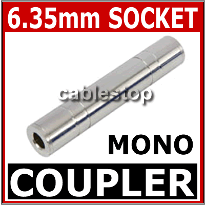

6.35mm 1/4 Jack MONO Female Socket to 6.35mm 1/4 Jack MONO Female Socket
