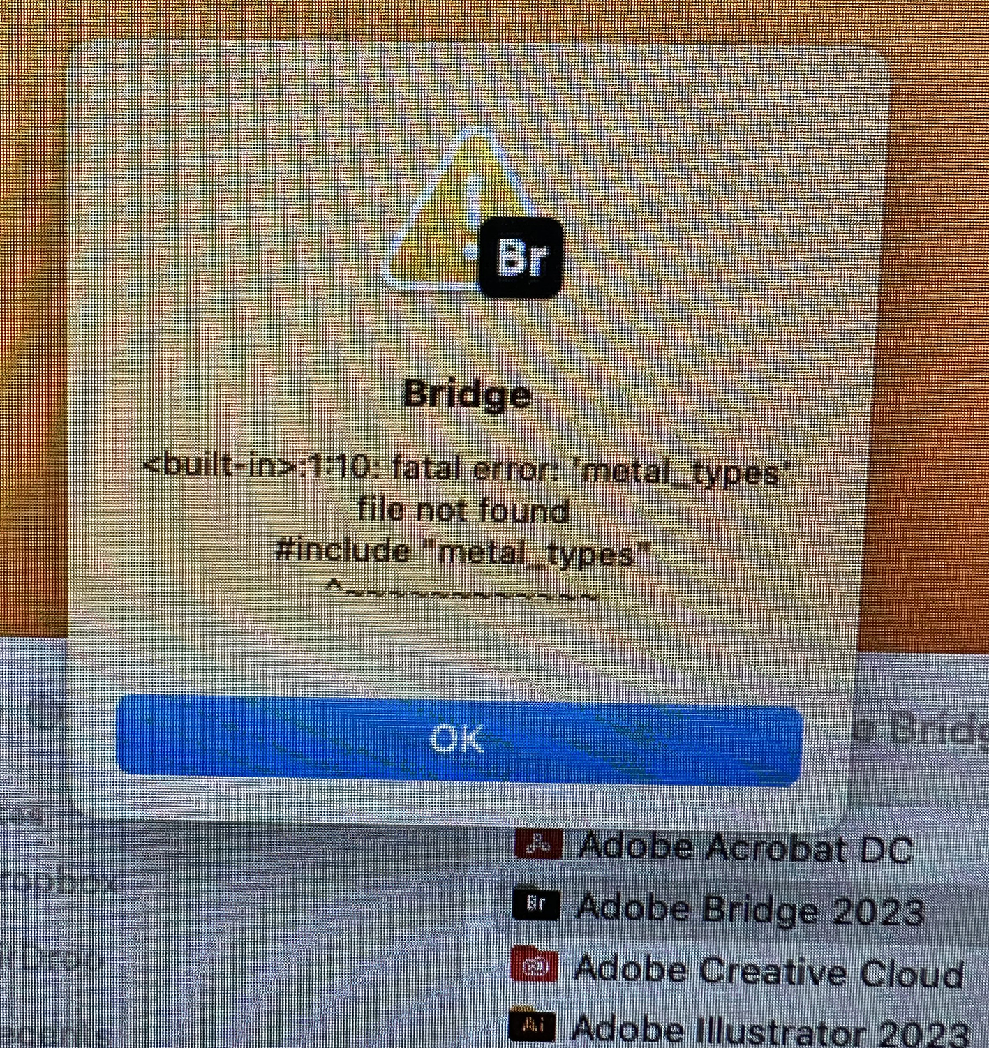

Clear nstalled on iMac 2013 with disk formatting ventura 13.3 via open core patcher. Everything works well, except for two things. Does not display icons in the system settings and adobe bridge of any version does not start (the licensed adobe package other graphic programs work fine, photoshop, indesign illustrator... Usb installer was created on a computer of the same line but with a different configuration. This is bridge error. Any ideas?

You should probably post in the thread about unsupported Macs running Ventura. There you will find posts similar to yours and solutions. Can you include more info when you post? OCLP version, etc.
Try running the latest version of OCLP from that Mac and do the Build and Install option then reboot. Re-running the Post install root patches may help too. especially using the latest nightly version (see prior posts for that). I suggest updating to 13.3.1 too as it has some important security fixes.
