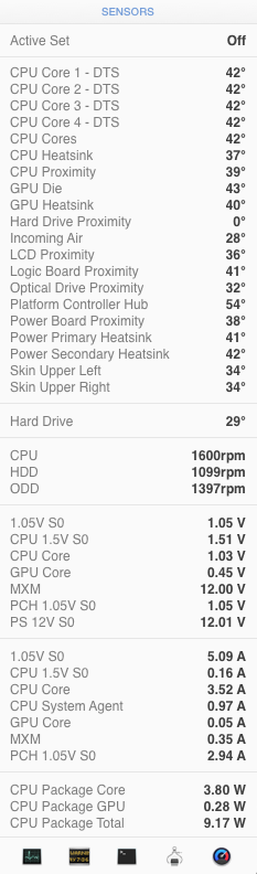

I'm not sure how to check the sensors but this is my readings from iStat menus.
If this ain't the sensors you're looking for, what is the program to check the voltage of the RAM? And by the way, this is the RAM I'm about to buy and everything looks exactly the same as required for this specific iMac.

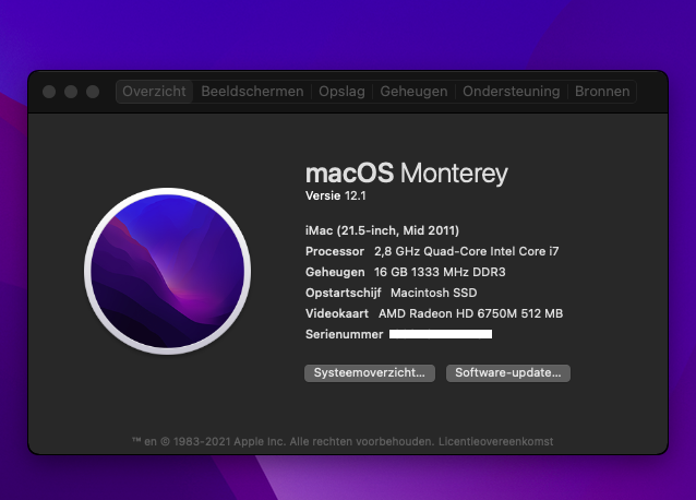

Still haven't time to put the graphic's card (GTX 765M 2 Gb) into my iMac 21,5" mid 2011, but I installed Monterey 12.1 with OpenCore Patcher. It works guit good, little problems are solved ,(wifi wasn't working, is now working!) only some small graphics issue, like split screen not working, but that is not disturbing for me. I think that is the standard graphic's card has no Metal support and hopefully that will be gone with the GTX 765M card. More info later. Merry Christmas
Still haven't time to put the graphic's card (GTX 765M 2 Gb) into my iMac 21,5" mid 2011, but I installed Monterey 12.1 with OpenCore Patcher. It works guit good, little problems are solved ,(wifi wasn't working, is now working!) only some small graphics issue, like split screen not working, but that is not disturbing for me. I think that is the standard graphic's card has no Metal support and hopefully that will be gone with the GTX 765M card. More info later. Marry Christmas
Installed the Nvidia GTX 765M, boot normal, but is very slow, Monterey 21,1 didn't see the graphic card right, sees it as a videocard with 8(MB!!!!!),doesn't see the card as a Nvidia GTX 756M 2GB :mad:. Installed the AMD Radeon HD 6750M 512MB back and works oke!!.
