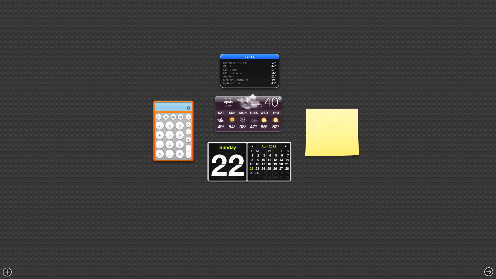

My iMac is currently at 109F is that normal?
The Intel processors used in Macs are designed to automatically shut down to prevent damage if they truly overheat. CPU Tjmax = 105C, GPU Tjmax = 100C on i3, i5, i7 processors. (Source: Intel) If you're not already using it, iStat Pro will give you accurate readings of your temps and fan speeds, among other things.

Drilling down into provided picture, I see your HDD temp is 52C. Yes. This is a great "C" temp for internal HDD. Temp betwen 45C to 58C is good. 50-55C for internal iMac is perfect.
To help keep iMac internal HDDs slightly cooler, do investigate your iMacs memory usage as well. Less Paging in/out, the less work on its HDD. Less tasks on its HDDs means less internal heat is generated. And, your iMac responds much faster as well (because less disk thrashing as well). If needed, do add more memory inside your iMac. After I installed additional 2 x 4 GBs (keeping factory base of 2 x 2 GBs) to create total 12 GBs RAM, I noticed my iMac ran much better. Thus, slightly cooler insides as well. Suggest minimum 12GBs ram - for general home user tasks. Hope this tip helps as well...
