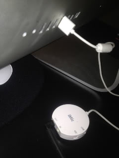

Very Simple Solution for you
I've got a solution for you guys. Apple Stores sell an adapter called "iMic"
It's made by Griffin.Essentially, it's a secondary output and input that plugs in Via USB. If you plug your speakers into that you WILL get both options under your sound preferences (Built in Audio & USB iMic) Literally, with just one simple click, I go back and forth from my studio speakers to my internals.I wanna say it was like $20. I'm sure they sell other things like this other places. Hope this helped!
