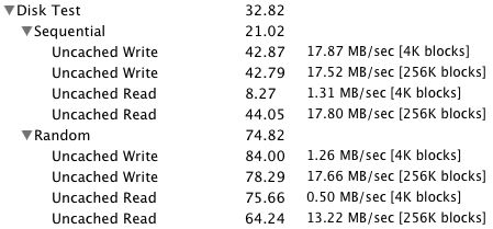

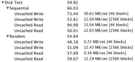

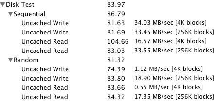

Here's my theory. A 48x CD burning speed is roughly 7.2 MB/sec and a 52x burns at roughly 7.8 MB/sec. Check out the attached photos. One is from my internal 4200rpm drive (4200.jpg), one is from an external Maxtor 7200rpm connected via USB 2.0 to my PB (7200.jpg), and the last is from a Power Mac G4 533Mhz with an internal Maxtor 40GB 5400rpm (5400.jpg). The random reads seem really slow; they are slow enough to cause any burner to wait on the hard drive. However, since most files would be closer to sequential reads (I presume. Other notes welcome.) then all three drives would be fast enough to support a 48x CD burner.
